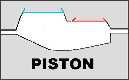

Just looking at the turbo chamber and piston using your terms Jmac and from what Ive seen so far so can be wrong! but would you say if someone is looking at under 7500-8000rpm its better to have small capacity David Vizard favored chambers as TK uses but making up for the high comp using dished pistons?. The dished pistons are a little heavier but better for heat dissipation and stay strong at these revs while the inlet valve providing it gets enough lift could be better deeper into the head so it creates a funnel like shape for the mixture rather than level with the exhaust valve? eg. creating less turbulence in the middle of the chamber.
Meaning the seats would need to be cut deeper into the head for the inlet only just enough to get a taper there to help the seat.
Here is a basic cross section of what Im trying to trying to convey
blue is the inlet valve deeper set within the chamber exhaust is red
I know there is more to the chamber but just wondering what if atm
as I understand the need to get the mix towards the centre but also
concerned on the combustion balance for that ball shape at tdc
without resorting to the more ideal hemi chamber.
There would be more bias or guided mixture on the outer edge of the
inlet valve while the centre area only has a taper halve the length.

Hemi chamber is not ideal. It's very good for high velocity airflow, but really poor for part throttle airflow. For naturally aspirated it has a poor compression ratio unless using a massive dome which is a tradeoff
Chrysler doesn't even use a hemi chamber in their HEMI engine!

Yep, even the hemi 6 didn't have hemi chambers, they were polyspherical. They flowed well, had some swirl (port size arguably too big for a stock a-b streeter, almost irrespective of cam choice at the milder stages, they all get a big kick in the pants around 3100-3500rpm as the port sizes finally get up enough velocity and you feel like you've got about double the torque by 3000rpm as you have at 2000 no kidding). and practically zero quench, which was to some extent an issue. It's a big reason the aftermarket heads go with the more conventional chamber shapes.
D - I'll try and tackle your question on the weekend, it'll be a bit bigger write up than I have time for tonight. And whatever I type, remember, it's only to the best of my knowledge, not written in stone!
