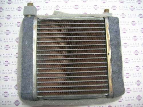

New heater cores are still for sell at the usual places
* Bprojects online store
* Monotaro
* Amazon.com.jp
I've heard that the Datsun 620 heater core fits, though the outlet is slightly different needed a hose mod
Also have you looked into Universal Heaters?
jpg  heater-core-b110.jpg (63.58 KB)
174_5d37738b2a938.jpg 640X480 px
jpg  Datsun 620 heater core.jpg (23.12 KB)
174_5d3773a1661db.jpg 400X332 px

One of the radiator shops might be able to recore it.
Posted on: 2020/12/1 5:16

I took my leaking heater core out of my coupe to a local radiator repair workshop and they replaced the core.

Ebay - * Bprojects online store
Still for sale, but for around $300usd :(
