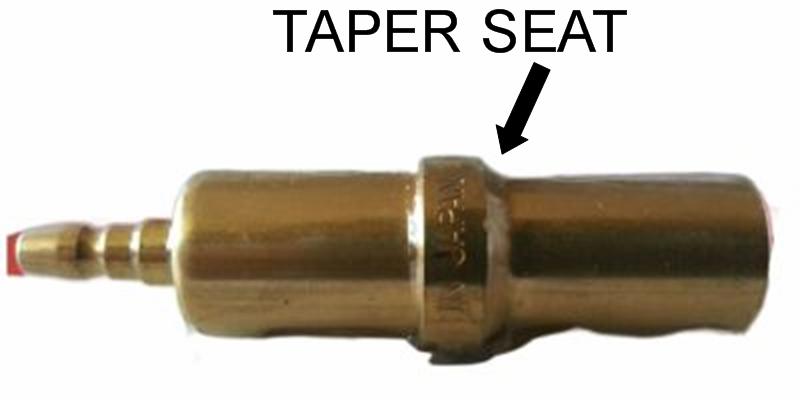

The Datsun 1200 temperature sender uses a taper seat for sealing
Nissan 25080-89900 GAUGE-TEMP ENGINE UNIT

the temperature sensor is just rattling around loose in there
It might something on the threads that is not allowing the nut to screw all the way in. Perhaps some corrosion or some old "pipe thread tape" somebody used in the last 50 years, not realizing these are regular threads. Try running a blind tap down the hole to clean up the threads
oh and to answer your question, no there is no gasket used on the temperature sender
