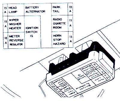

USA 1972 Owners manual (see pages 35 for fuse information):
If a fuse needs to be replaced, refer to the specifications listed on the fuse box cover.
Fuses
B110 uses the standard cylindrical fuses used by all cars until around 1980. The numbers are:
IG: Ignition Switch Circuit (only HOT when key is in IGN position)
- 'W' 15 AMP Wiper, Washer, Heater
- 'M' 10 AMP Meter, Reverse Lights, Alternator Regulator
Battery/Alternator Circuit (always HOT)
- 'L' 15 AMP Head Lamp
- 'PT' 10 AMP Park lights, Tail lights
- 'C' 15 AMP Radio, Cigarette lighter, Room lamp
- 'H' 15 AMP Horn, Stop lights, Hazard lights
There are also two empty holes in the fuse box to hold two spare fuses.
