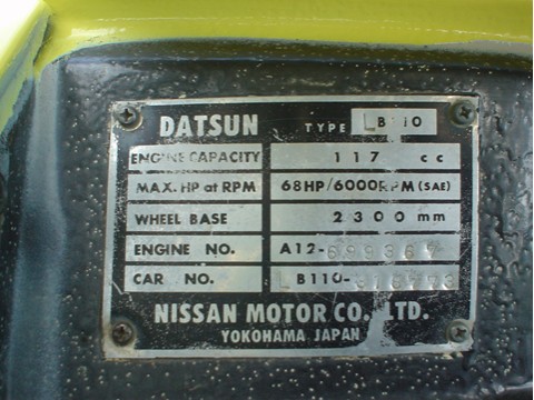

The wheelbase is the distance between the center of the front and rear wheels. All B110 Datsun 1200 models used the same 2300 mm wheelbase: Coupe, Sedan, 2-dr sedan, 4-dr sedan and wagon. The B120 Datsun 1200 pickup also used this same wheelbase except for the GB (long-wheelbase) model.

The B110 has a 2300 mm wheelbase, while the PB110 Datsun Sunny Excellent 1400 had a stretched wheelbase 40 mm longer. When the 3rd-generation Sunny B210 was designed, it used the same longer wheelbase as the PB110. The new B210-based Excellent (PB210) used this same 2340 mm wheelbase which continued through the B310 (last of the rear-wheel-drive models).
