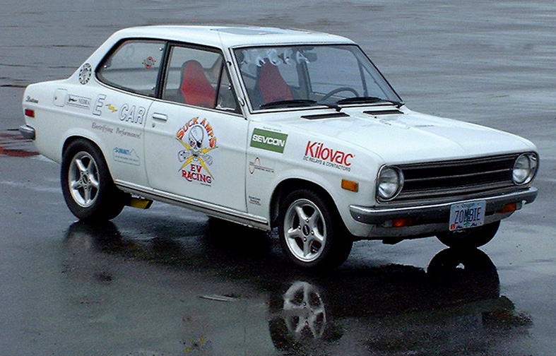

White Zombie is a 1972 Datsun 1200 2-door sedan. As of 2014 it is the world record holder for street legal electric vehicle, running the 1/4 mile in 11.4 seconds @ 114 mph. White Zombie is optimized for 1/4 mile runs, rather than range (miles before it needs a recharge). It's now run 12.99 @ 101 mph and is a member of the "100 mph Club". See POST Wayland's 1200 Breaks World Record.

White Zombie 2004 Specification
  • Dual 8 inch Warfield series wound motors advanced 12 degrees, connected shaft-to-shaft, and wired to either run in series for 0-~70 mph or wired in parallel for 70-115 mph or so (100 mph 6500 rpm)
    evalbumᴬᴿᶜᴴᴵⱽᴱ
  • 10 mile (max) range, or put another way, 40 lazy quarter-mile runs or 1 full-on run
  • 0-60 mph time: 4.5 seconds (estimated)
  • Charging time: Fast-charged in 8 minutes between runs (200 amps)
  • 24 Exide Orbital 12volt batteries -- 288 volts, each battery weighs 40 pounds
  • Previous run with 336 volt pack, but that's a heavy pack!
  • Motor is controlled by a 1400 amp Godzilla motor controller, modified by Otmar, plus my 'Afterburner' controller bypass that connects the paralleled motors around the controller directly to the full pack voltage with ~ 2600 amp power rush...enough to break traction on a sticky drag track at speeds around 70 mph
  • No transmission. Direct drive with a beefy drive line from the rear motor's output shaft, through a center carrier bearing, and onto the input flange of the differential
  • Ford 9 inch rear end with a 4:56 ratio. Currently, the rear end setup has twisted axles, a damaged pinion, damaged gears, a mini spool that locks both axles together, and the smaller street sized 28 spline axles
13601.jpgAlbum 13601
  • Plans for drag racing spec Detroit Locker ratcheting-full locking differential section with the bigger 31 spline axle drives, custom machined drag duty racing spec 31 spline axles
  • street-legal drag tires
  • Tires: Rear....BF Goodrich DOT approved, 215/60/14 'Comp T/A Drag Radials' on Ford 5 bolt, 14 X 7 five spoke Eagle polished alloys
  • Tire: Front...Nitto DOT approved, 175/50/13 'Exit GS' on Nissan 4 bolt, 13 X 5.5 five spoke Eagle polished alloys
  • Wheels: The front are 4-lug (standard Datsun suspension) with spacers. The rears are 5-lug to match the Ford 9" diff assembly, which is considerably wider than the stock axle
  • "slapper-bar" style traction aid
  • rare Datsun Competition 10 grand tachometer (Kantoseiki, optional, not the 8k rpm option tach)
