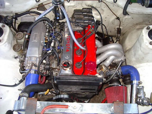

 Re: 4agze 120Y engine bay all finished and its driving :)
| Poster |
Thread |
| kululadotgroen |
Posted: 2008/2/13 6:48 Updated: 2008/2/13 6:48 |
No life (a.k.a. DattoMaster)   Joined: 2006/7/12 From: Cape Town ZA Posts: 1054 |
 Re: 4agze 120Y Chim chimney, chim chimney, chim chim cherooo....*hehehe* Man it's good to turn that key the first time after one made some changes and it stands there purring like a kitten, albeit like one with a furrball stuck in it's throat. I was just as excited the first time I could start mine, I didn't hae much on there either, altough I did have a fanbelt on... Let us know when you've taken it for the tune, would be interesting to see what you make. I don't know if you've given it some stick yet, but you should have felt already that it's a totally different car now... EDIT: Ooo, I almost forgot, time to change that avatar now...

 Re: 4agze 120Y This is the latest addition, raised boost from 8psi to 13psi

 Re: 4agze 120Y Quote: I cbf changing pulleys and ####. ^^^ LOL! it's a nice setup man, i really like it! what do you think the power figures will be like with the new pulleys?
| Poster |
Thread |
| Tyrie |
Posted: 2007/9/6 8:05 Updated: 2007/9/6 8:05 |
No life (a.k.a. DattoMaster)   Joined: 2004/5/4 From: Canberra Posts: 4200 |
 Re: 4agze 120Y haha its so much easier to do the work when they're sitting right there and I have 2weeks break from uni I really need to get it tuned and get a power reading, I'm #### at guessing. A 4agze sprinter I know made around 120rwkw on 12psi I'd be more than happy with that.

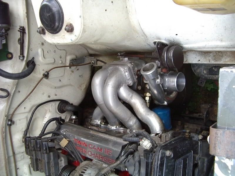

 Re: 4agze 120Y oooh what's this?
| Poster |
Thread |
| frankthedolphintrainer |
Posted: 2007/11/10 8:11 Updated: 2007/11/10 8:11 |
No life (a.k.a. DattoMaster)   Joined: 2006/6/8 From: Brisvegas, oz Posts: 2173 |
 Re: 4agze 120Y sweeeeet i love it. there some pretty crazy lookin exhaust manifold, so many bends

 Re: 4agze 120Y The bends in the 1st runner are to clear the cam angle sensor which isnt installed in the pic. Yeah Lachie I brought back a turbo 4age with gearbox in my 120Y, resting my arm on the plenum all the way
