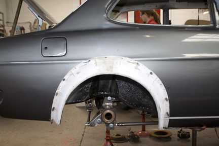

you can see some of the rear setup in this pic. Its a toyota Hilux diff with a 4.1 LSD head. Its been 4 linked with a watts linkage and coilover shocks and springs. Rear brakes are going to be S13.
