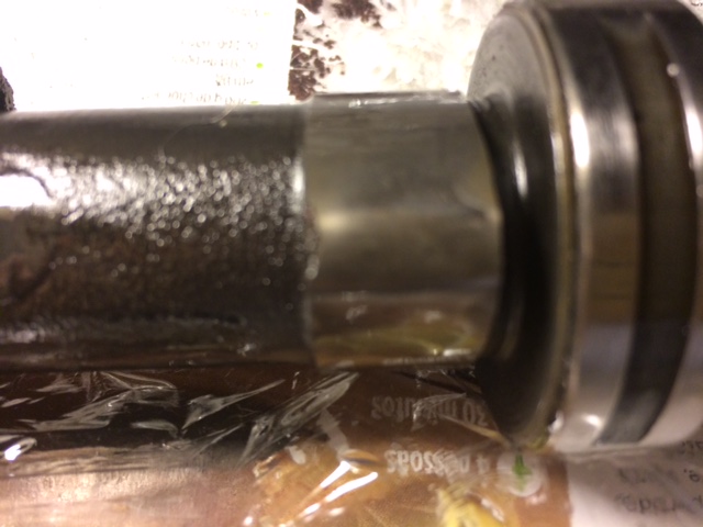

i taken measures on camshaft with more precision, and the cams are ok, but some have some shadows and one have a litle material dent.
Please give me your opinion? Its a big deal? or take the risk and assembly it with this material dent on cam? The lifter will make some pressure in all cam and will toutch the dent too, im afraid the lifter will increase the cam dent?

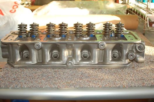

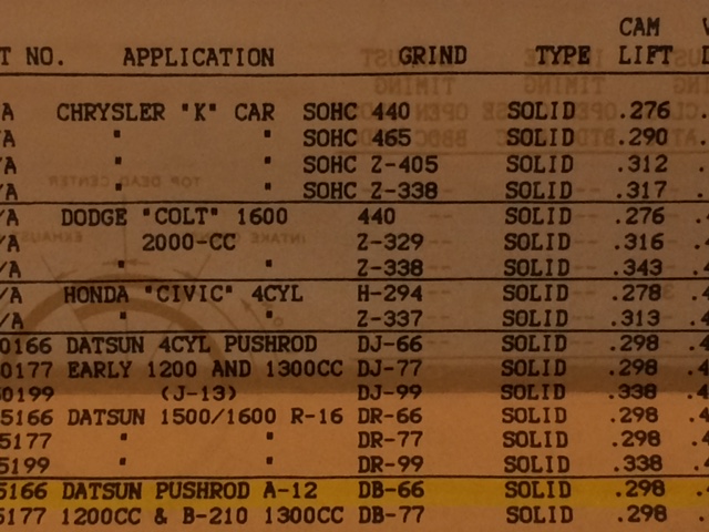

Hi!
Only on November i will make the oil head test im far from car....
I read on springs specifications:
"This item is worthy of middle class specifications enough.(To about 8,000 rpm spec)
They are Valve Springs popular very much in JDM.
The double valve springs control Valve Surging at the time of high rpms.
It supports; cam lift - 6.5mm, valve lift - 9.4mm"
And the cam lift is 0.298" or 7,57mm that is i saw on paper..
Cam lift 7.57mm is biger than the spring can suport?????
Please let me know

I hope not assembly the springs in wrong way?????

These are the itens i used, and i kept the standard spring lock retainer
