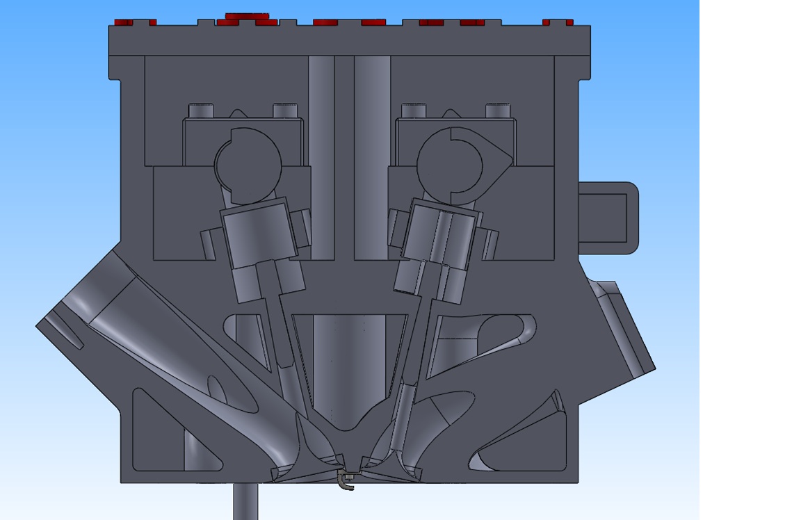

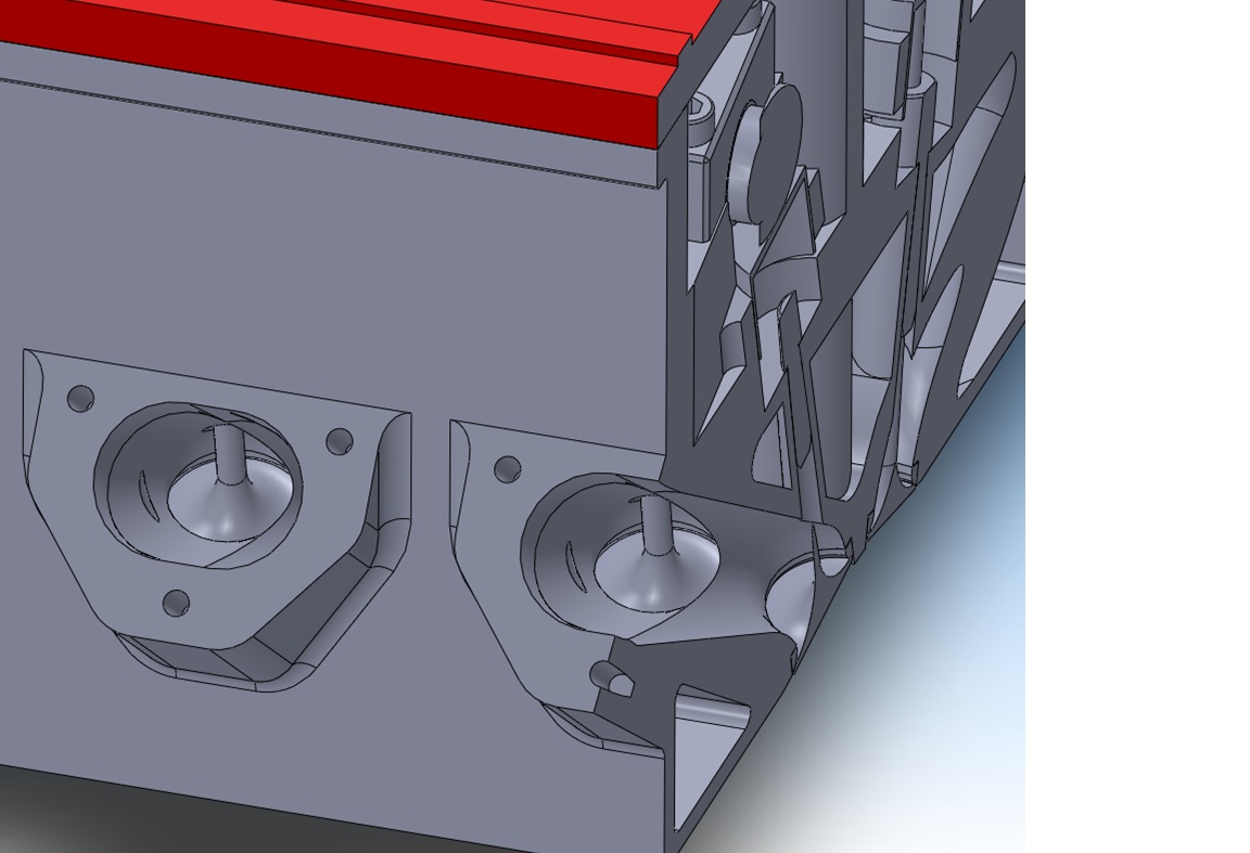

D the ports are about 40° at the moment. They still need a lot of work but at the moment I'm trying to get a complete model together. After the model is complete I still want to do some flow simulations and see what improvements came be made.
Here are a couple more screen shots of the inlet ports.

I can see you've spent some time on that! Looks nice.

Great work keep at it and do it how you want its your project will you be producing these in the end or is this a modeling excersize i would be keen if they are an affordable power upgrade under 2k hope you mass produce these sell heaps and make your hard work pay off and be the first to get it done

Its really looking fantastic, when you get to the flow simulations it will be interesting how much a difference it will compare to tapered inlet runner and more angle as in the line indicators below.

Thanks for the comments guys. It is a very interesting wee project and I have been learning plenty along the way.
I have been doing some homework on the manufacturing and looking at pattern making and rapid prototyping etc. Are there any members on here that are pattern makers or have experience with casting or foundry work?
D what you have sketched is very much what I will be trailing with the flow simulations. The ports at the moment are far from ideal.
