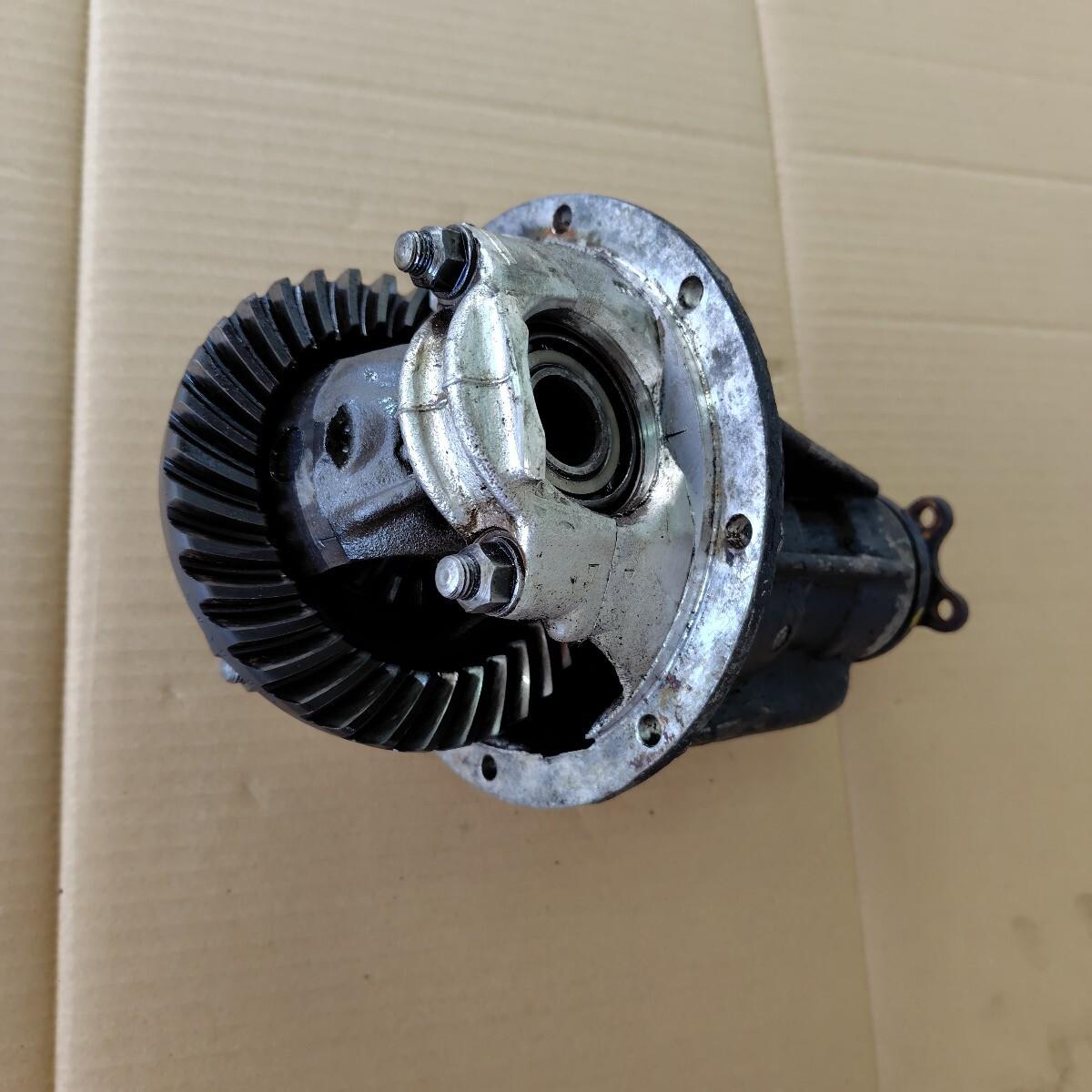

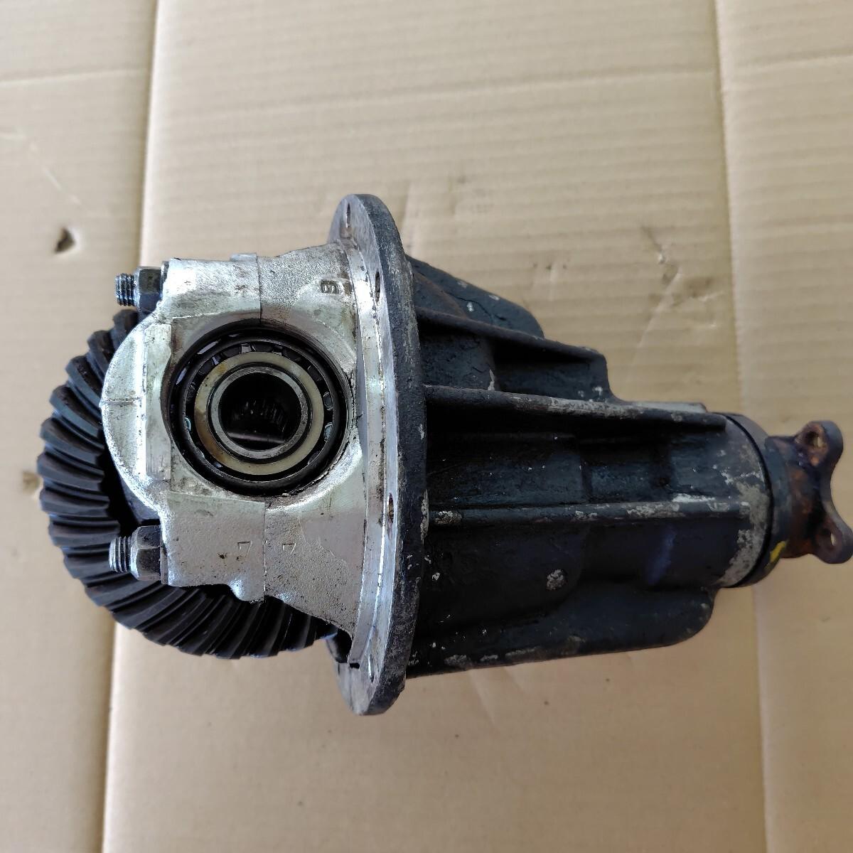

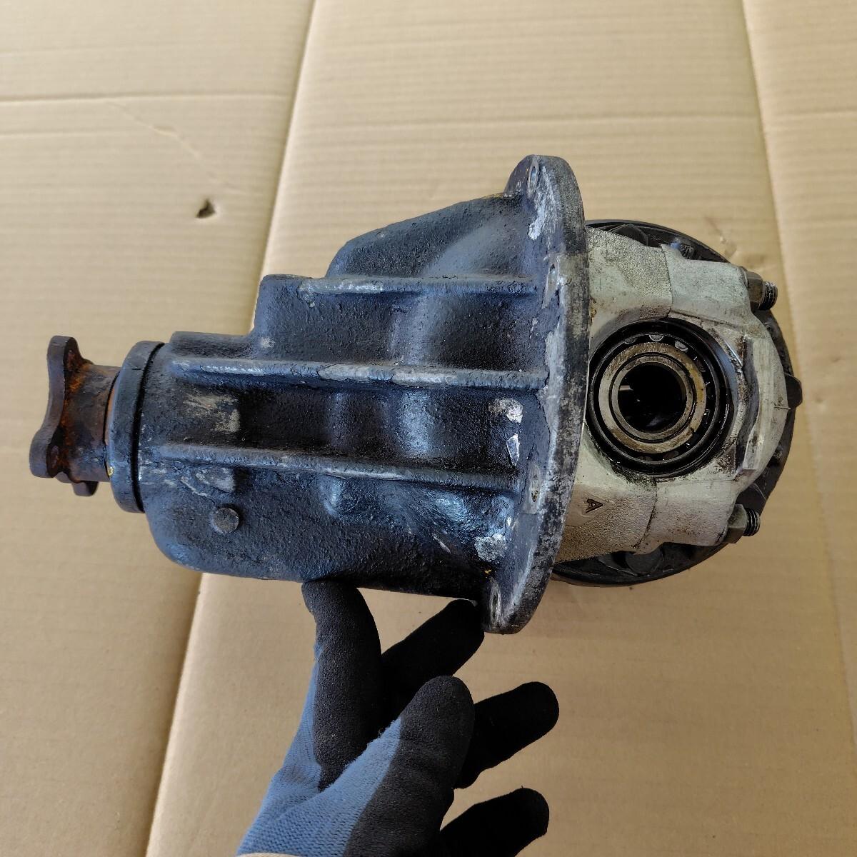

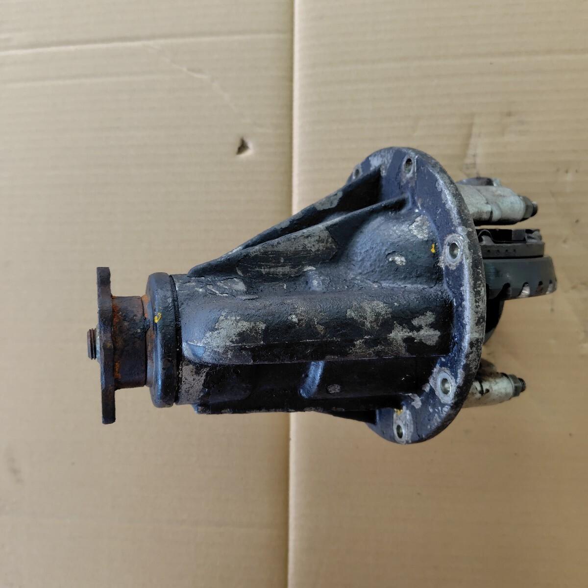

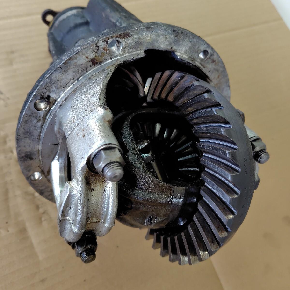

Datsun Sunny 1000
B10 4.111 (37:9) sedan & coupe
B10 4.375 (35:8) van
B20 4.625 (37:8) truck
All use the same GEAR CARRIER part number 38310-18000
the bearing cap fit over studs and are secured with nuts
It also does not use the cheap crush sleeve that the cast iron H145 does, but instead has reusable shims
