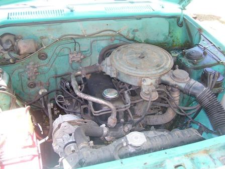

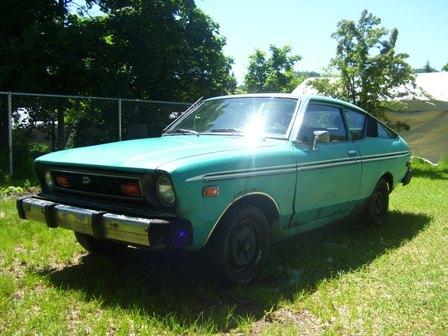

Here it is all orig parts and trim in excellent shape.
jpg  B210.jpg (37.18 KB)
11027_4a72761b9bf99.jpg 448X336 px
jpg  B210-int.jpg (26.60 KB)
11027_4a72762e7fb72.jpg 448X336 px
jpg  B210-eng.jpg (28.97 KB)
11027_4a72764e90511.jpg 448X336 px

hi mate thats a nice b210 fastback
Definatly not a fan on the front bumper !
take a look at the ones we have here in OZ
