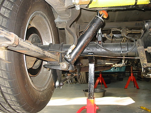

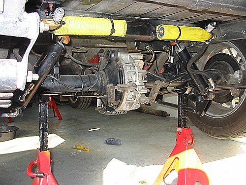

Made a big difference on the drag strip for me, also built a tray mount swaybar control bar thingy that I copied off a US drag forum. You can see the brackets on either side of the diff, with arms going straight up thru the tray. Best thing I coulda done, short of a full 4 link rear clip.

thats awesome bones... yeah i cant afford a 4 link rear clip for a long time yet... im thinking ill need something like this with the SR.

Bones is that your setup of one from SAfrica? (surely not the states??)
Thats the famous Alfa diff I want to use, apart from all the finning its has
a finned oil sump, absolute beauty.
Nick, Im in for the group buy on those things! especially since your going IRS :)

Yep, thats the Alfa 4.3:1 LS diff which is in diff heaven now. Heres a pic of the tray mount anti roll bar. I sold this rollingchassis complete a short while back, and I'm on the hunt for a new chassis. Check out competitionengineering for design cribbing Heh heh
