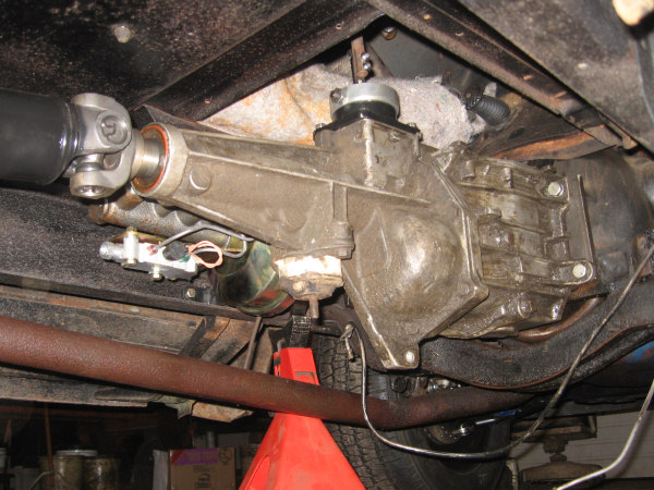

I am currently making an adaptor to go from a Dellow T50 bellhousing to a Getrag 262, I am using the Dellow bellhousing because all of the clutch work is already done and all that is needed is an adaptor from the Dellow to the Getrag once the input shaft has been positioned.
It's on my 'to do ' list to do the same for the Dellow - W series box.

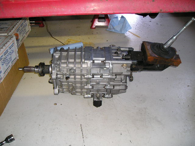

This would be the T5 Id be interested in, note the shift position
jpg  t5.jpg (102.87 KB)
737_4be52167b97ba.jpg 600X450 px
