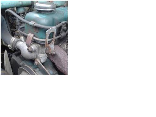

I have removed my Thermostat and running the car without it as my dash gauges were problematic,Now i have made the dash gauges, and thought of installing a new thermostat as my car is running very cold as below pic, can i do it my self any advices on this, i don't see any screw or anything to tight it up in the outlet,i got 2 bolt screw type outlet as per the picture here

pretty easy to do. you need a workshop manual.
you undo the 2 bolts, drain the coolant, clean the old seal off the housing and the head part- dont let any fall in the head.
install the thermostat correct way round and place paper gasket or use gasket sealer.
let the sealant cure slightly, bolt it up then wait 12 to 24 hours for sealnt to fully cure. fill up with coolant and test.

Not too much tension on the bolts, they break easy.

Then thermostat is just tighten between engine housing without any screw is it ? then put the gasket, then housing and tighten ?

That is correct Sumith,
The thermostat will fit nicely in a small recess machined into the head. It just balances until you put the housing back on.
As unfamilia said it very easy, paying particular attention to the orientation of the thermostat (look at the old one as you take it out)
I have used sealer and gasket and there doesn't seem to be much difference really, except sealant is easier to find and reapply if u do stuff somethin up.
Ivan's advice is very good, remember the bolts are steel and the head is aluminium. In fact sealant is quite good because it is flexible the packae usually reccomends only doing the bolts up finger tight while the sealant cures and then applying maybe 1/2 a turn with a spanner to make it seal watertight

he doesnt have a thermostat in there at the moment, only go in one way really, with the spring facing to wards the front of the car from memory.

right you are, oops ;) I hope you can remember how it looked Sumith.
But Unfamilia is right about the spring.

and look for the small air hole has to be on the top mate its not hard at all if u need help let me no
