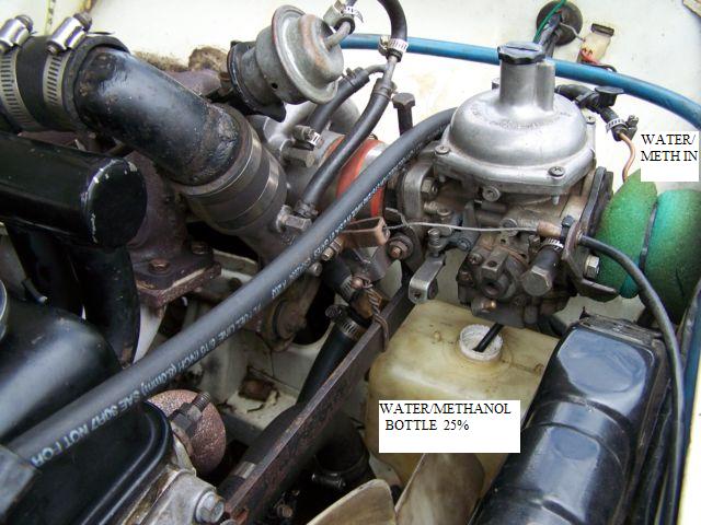

This is my high tech water/methanol setup The wind screen washer pump switches on at 5psi and pressurises the system recirculating to the wind screen washer pump. At 18psi an in-line solinoid opens and the water/methanol is injected between the air filter and carby. Im using Hobbs (brand) switches to trigger the pump and solinoid ($50.00 each but you can adjust them from .5psi upto 30+) I have used a washing machine pressure switch before but this had very little adjustment and was quite bulky (I put it in my pigma porkion turbo with a similar water/met setup and it works just fine.Open in new window

hey do you have a picture of your exhaust manifold??? also are you using a 1 3/4 su from a jag of sumin?? looks mighty fine.

It's not an SU, it looks like a Stromberg CD [Constant Depression] carb.

ask and you will recive. Yeah Dodgeman is right its a zenith/stromberg cd 1.75 but if i could get a cheap one id go for a 2 inch suOpen in new window
