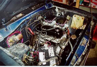

Jaimie,
Have you ever seen this picture?
Someone from the Yahoo 210 club sent it to me. Although you can't see it very well in this photo, he has built a twin downdraft setup. He claims it ran good, but opinions can vary on what "good" is.
In my opinion, twin side drafts would always be faster than a setup like this. But I like the way it looks though!
