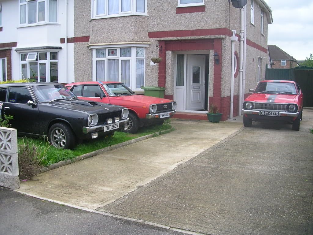

edit: im lost wat cars are they???

The cars are Datsun 120A FII Coupes
