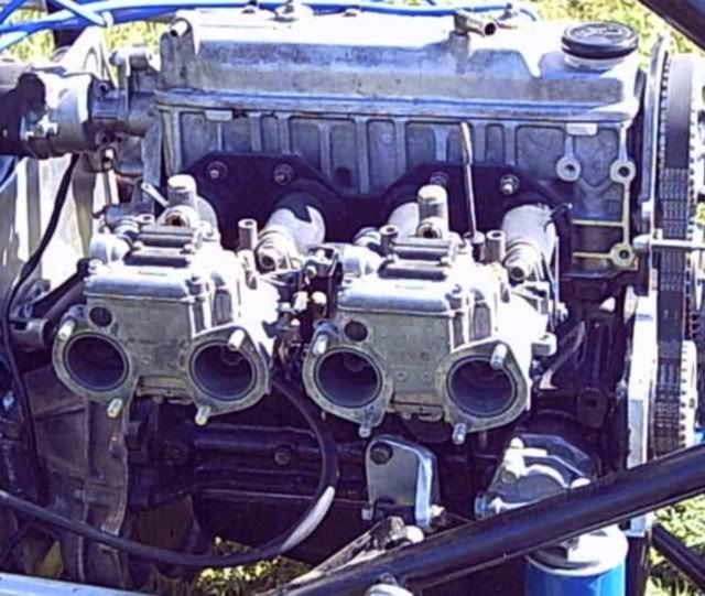

For a while I had a picture of an A series speedway engine with the sohc head from an E series, but the question here was about Double OverHead Cam heads, so I didn't mention it earlier.
None the less, at least one running A series engine lives with a cammer head. I think it uses an A14/15 block with A12 crank & foreign rods & pistons to allow reliable 10,000 rpm engine speeds. [Well, reliable in a race engine sense anyway]
EDIT
Found it. Study the side of the block & oil pump. It looks like an A series to me.

Feral showed us a DOHC head that bolted directly onto the A series block, however, physically bolting it on was one thing, but getting all the coolant & oil passages to work out was another.
Geting drive from the crank to the cams was yet another engineering nightmare to be addressed.
