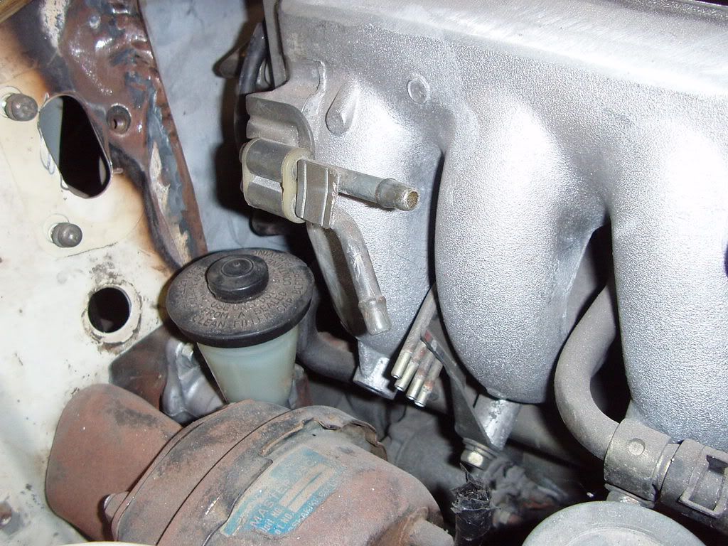

The top one is the inlet to the fuel rail, the bottom one (that points down) is the fuel rail return line (that your plumbing into your fuel tank).
Your diagram looks pretty good to - by the way. Also I just bent up my fuel rail (just finished) will post a pic later tonight! You can view topic.
