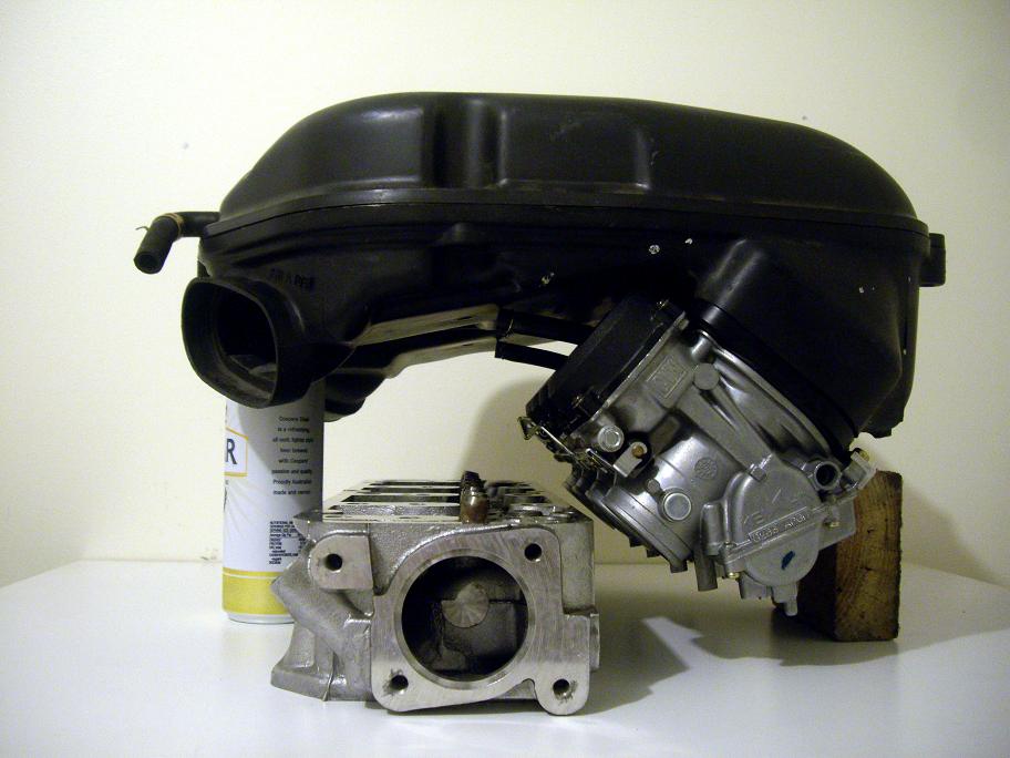

would bolt to the carbs mount if you flipedd it around 180? tha would give you clearance.
for a $20 air filter housing- dont spend heaps of $$$.
mod it to fit with out rocker covers, push rods mods etc.
and you could still access the oil filler cap

Ugly? I couldn't give two shts what it looks like, it's under the bonnet and like Mik said it cost me sweet FA.
But I looked at flipping it and that didn't look like it was going to work, I could remove some of the plastic to help it clear the rocker cover so that's another option. I guess I'll make the manifolds first and see what I am left with.

i wouldnt want to mess with custom sumps or rocker covers, make the manifold fit even flush with the top of the rocker cover(at least it will be secure to the rocker cover then- tech screws lol) and make a bonnet bulge.
Posted on: 2010/8/7 1:44

If you really want to use the black plastic filter, then i would go down the modded bonnet option.
The cheapest is a bolt on hornet scoop.
Else a moulded fibreglass unit that looks similar to the BA falcon XR bonnets.
Stuffing round with cutting rocker covers, sumps, rods, is all too hard and expensive.
Just keep in mind that as soon as you cut the support bracing from the 1k bonnet they fall apart. Hec as soon as the cross bracing comes away from the bonnet it starts to become flimsy.

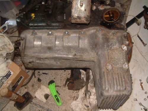

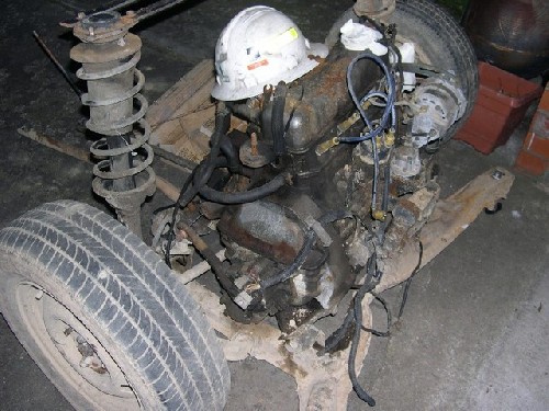

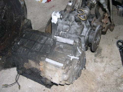

Seriously you cant beat a retro looking setup. Otherwise....
Ill add another option, find another B10 then how about a short
Metal fabrication night course with your b10 as the guinea pig? :)
Then how the Craziest A series setup layout ever using factory ported head.
Box framed rear mounted A14 with 81mm sleeved bores (or bigger by Lemonhead)
using pulsar n10 5 speed FWD equal length driveshaft box driving the rear wheels
then the skys the limit!!.
Look at the N10 pics from Wombat Racing the Dude in the Muff shaped Oz state.
