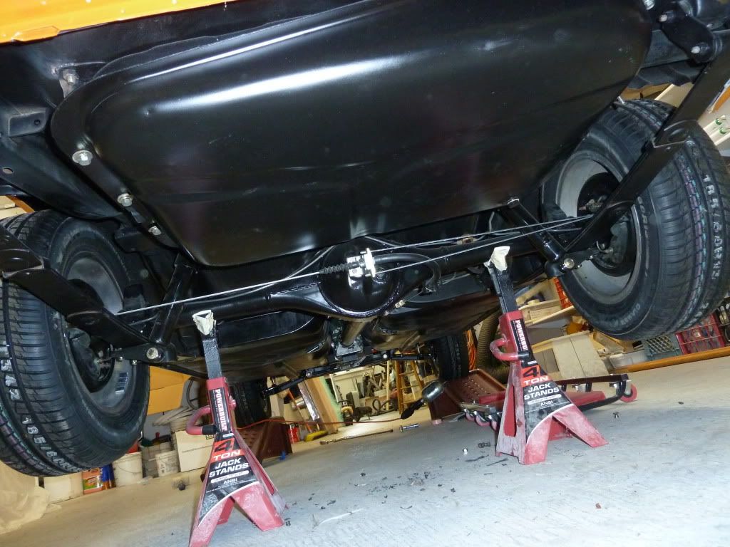

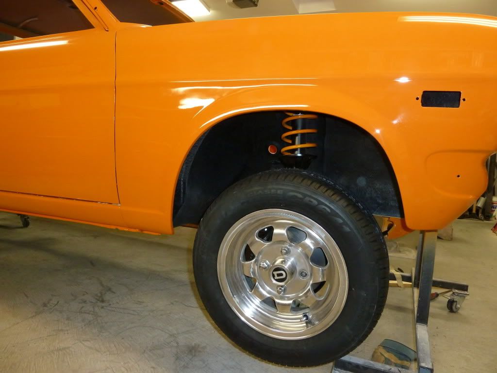

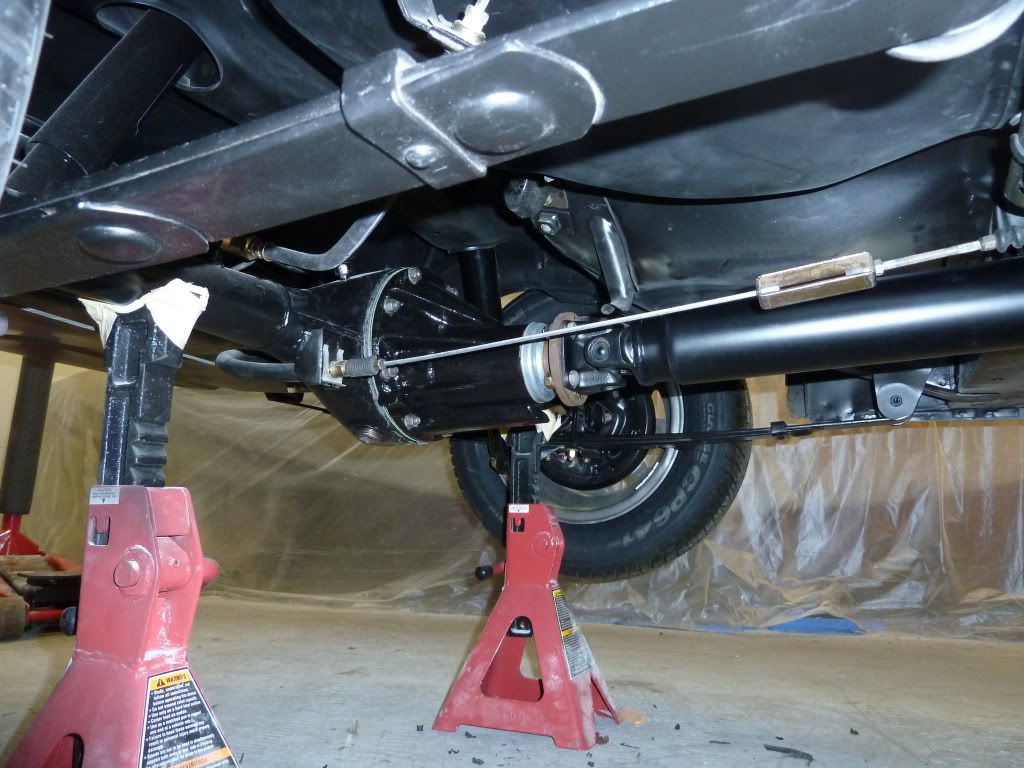

suspension almost completely in w/2 wheels on....
now if I can only get the pitman arm off the steer box so I can replace the seal.

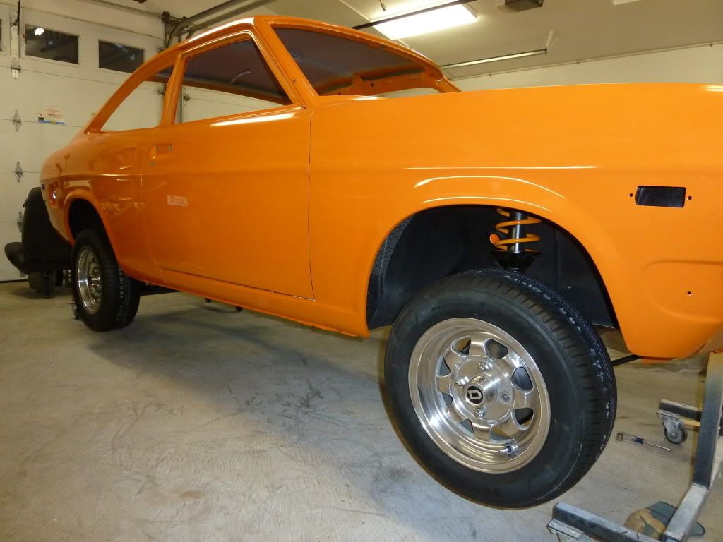

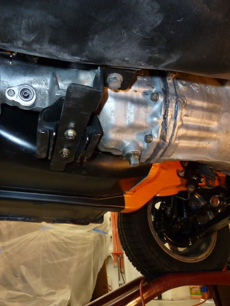

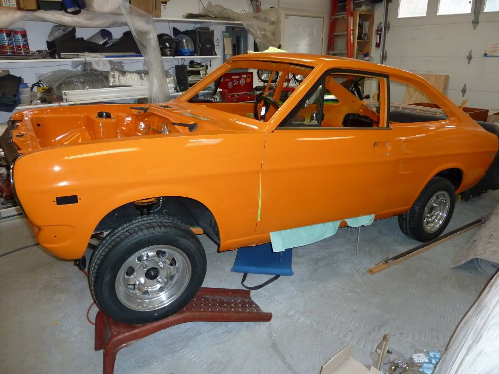

well a few pic's to update the thread - drivers door back together, sound liner in the car, all suspension on, touch up painting on the frame where the stands attached is finished, trans mount fabbed up for the 60A 5 spd. & misc other things accomplished. Starting on the headliner so I can get the windows installed under the rubber seal.
headliner
all for now.....

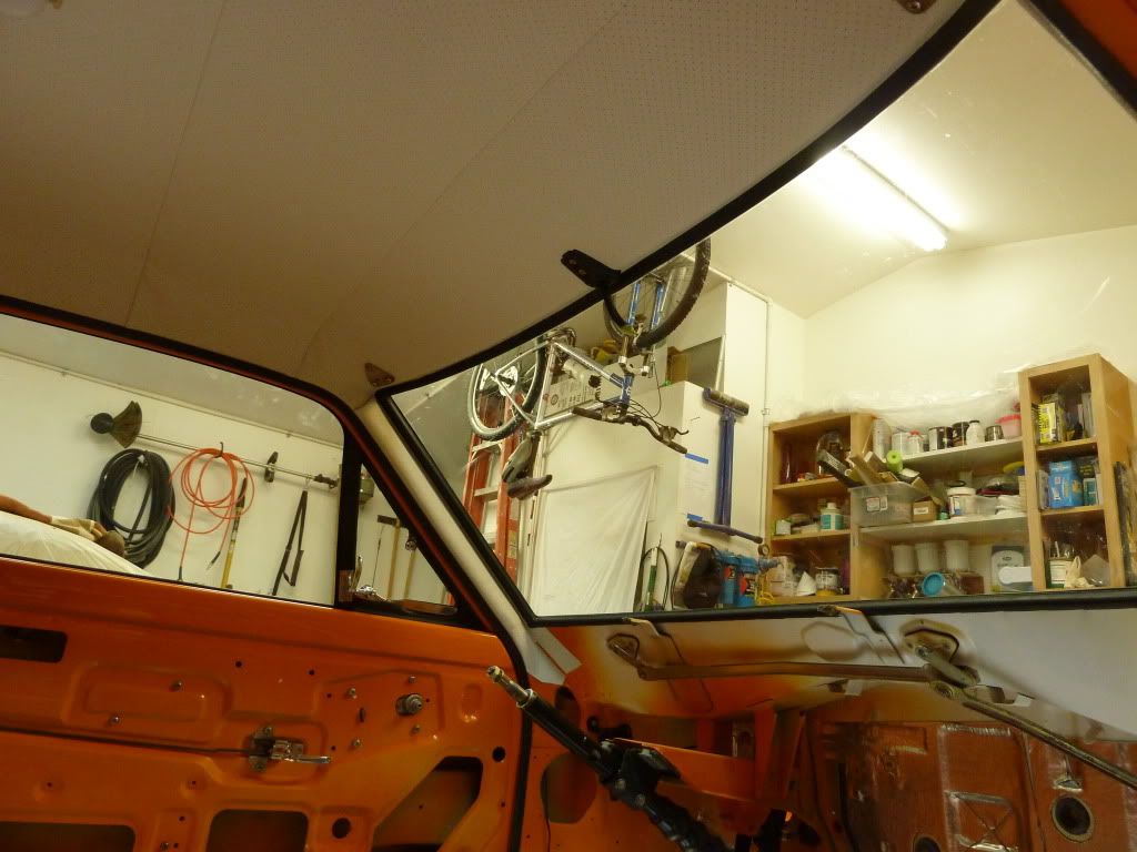

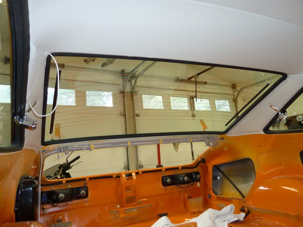

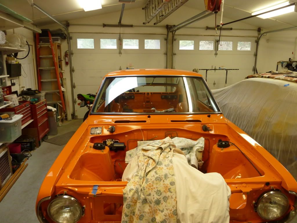

Update.......
So I made a new headliner & just got it installed. That's a 1st for me, I think all in all it came out pretty well considering I'm no upholsterer - it'll have to do.
I think this'll be cool - the wire dangling from the old mirror base (took it apart & used it as a grommet) will feed my new rear view mirror thats auto dimming, compass, temp & map lights!
now I can get the ft & rear windows installed & move forward on the dash & the rest of the interior, wiring, AC, etc... as well as the drivetrain, hopefully it'll go quicker now.
all for now.

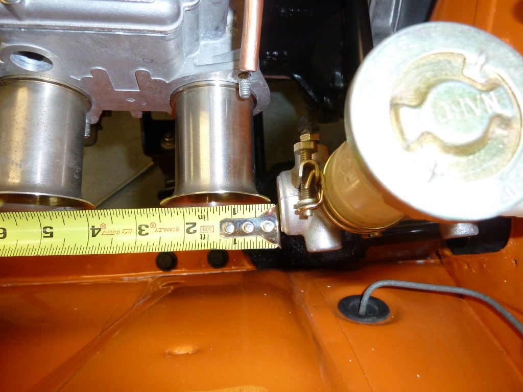

More updates....

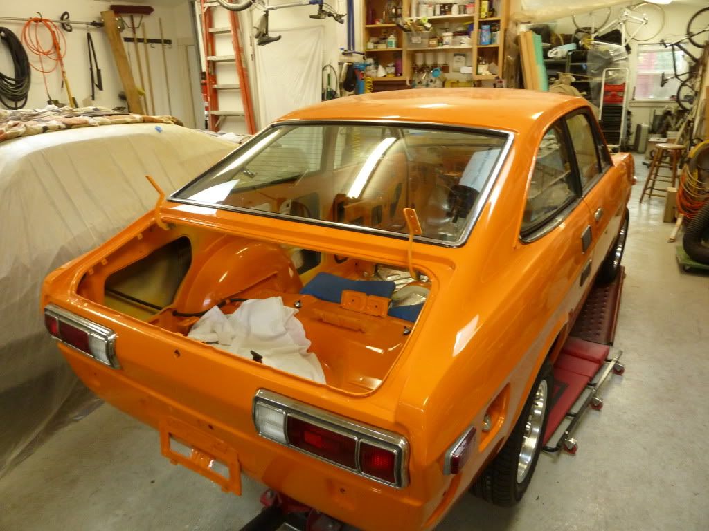

Glass in - yea!!!!!

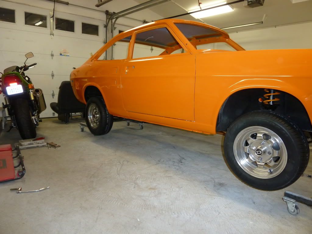

Engine w/rebuilt DCOE & ceramic coated header, 60A 5 spd. trans, H150 3.7 rearend & driveline in....
Oh yeah, electric fan w/3/4" clearance to pump remaining...

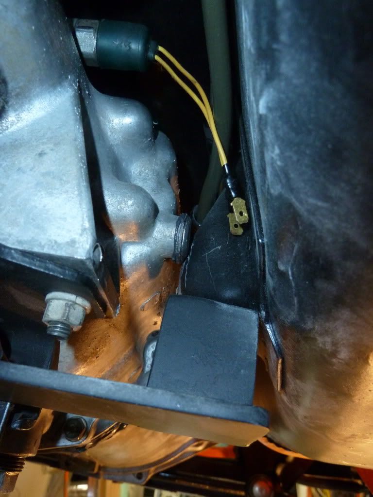

reverse switch plug - 14mm x 1.5 drain plug w/head cut off, a slot in the top & beveled edge to get it to fit - what a pain!!!
MC & air hore clearance.
hopefully more progress soon.
