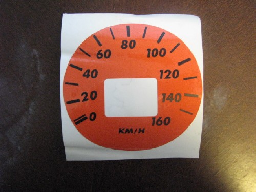

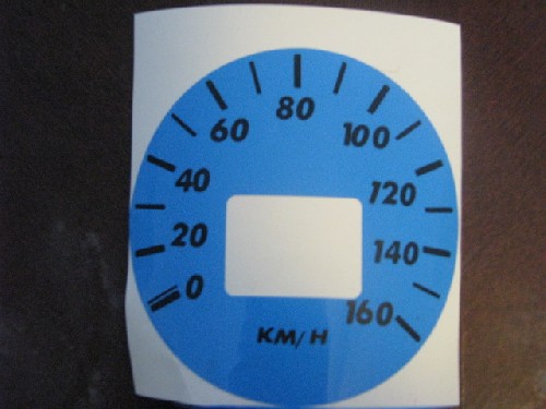

Thanks bro.
More colors added.

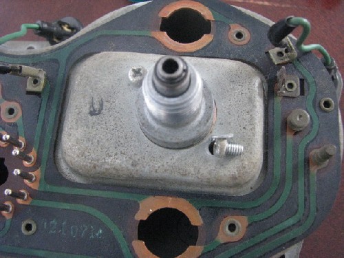

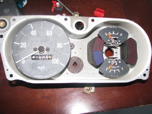

I'll have these in kmph in carbon now mate. Also, can you tell me how many lights to replace all in the dash?
EDIT: ok, big thanks to the tech wiki, the dash takes 9 bulbs in total, seven inside gauges, two on oter edge, which would be the turn signals. So my question is (bear with me as I dont have my car atm so cant check for myself) how many of these do i replace with blue leds, and how many, if any, do i need to keep white because of coloured plastic filters ie high beam, oil etc??

Ok,
There are only 3 lights that need to be Led's. 2 go on the speedo part( these can be 120 degree bulbs) and the 3rd light goes in the middle on the Temp/ fuel location( this one can be 360 degree bulb, since there is only one).
Make sure you knock off the green covers. I left all the other light untouched.
Hope this helps :)
