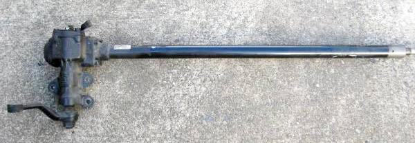

Posts: 31866
That's not normal.
I dunno what would cause it. It might be Collapsible column -- the 1200 was in a wreck, or driver hit the wheel with a hammer trying to remove it.
Most 1200s don't have a collapsible column, but perhaps the newer 1200 utes do.
The Collapsible Steering Column has diamond pattern plastic covering like this:
The regular Steering Gearbox (non-collapsible) column is plain tube:
Posted on: 2011/5/13 1:55

Re: Steering wheel moves???
2002/6/14 7:24
From Sydney
Posts: 2598
take the column and box out as one assembly. As two things will usually happen if you separate the column from the steering box. * oil will go all over the place and * more times often its a complete bitch to line up the bearing at the base of the column when inserting it back into the steering box. For the sake of three bolts [that mount the box to the chassis rail and the tapered shaft that connects the drag link to the steering arm, I find it easier to pull the whole thing out.
