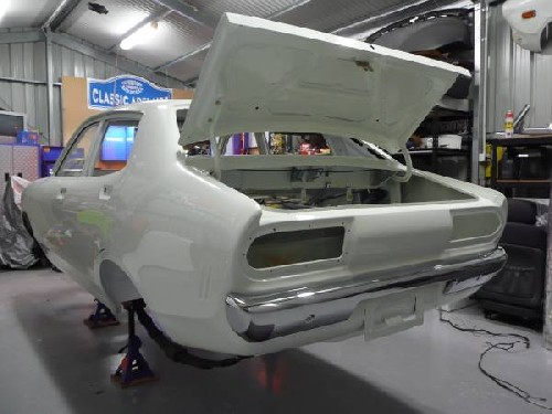

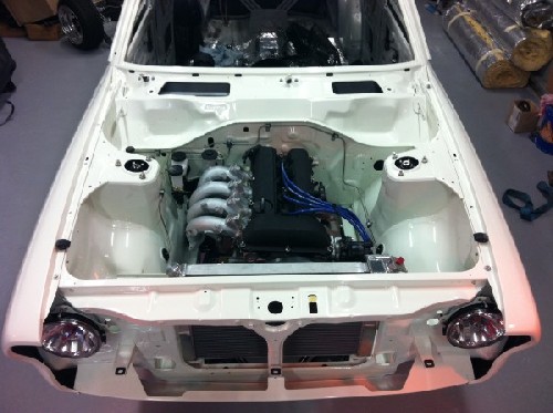

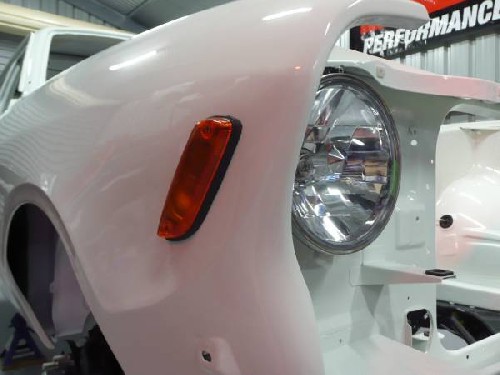

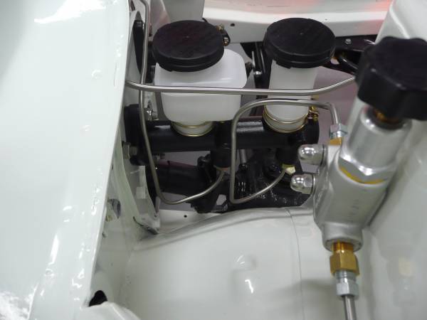

Got the brake lines finally finished. ran so many different variants , happy.... i think. Had the car colour sanded on the weekend so i can now put bumpers and all outer bits on. Sprayed inside of bumpers with sound deadner , re painted brakets and bolted them on. Painted headlights mounts and polished trim rings. All ready to put motor in on the weekend :)!!
A big thank you to Tony and Jo and All Brake and Clutch in Adelaide for their help the last week sourcing bits for me .

Im trying but theres so many little bits to do :)
Got the engine in, now lunch break is finished clutch is next.

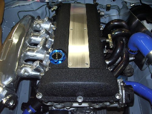

looking great love the dash set up, makes me think about finding a 79 set up to fit in my 81, and the valve cover looks so fimiliar, like i've seen it before, lol, alot of attension to detail. love it.

Very nice, what size master cyl are you using for the brakes?
And no booster?

Master cyl is a 7/8. Worked out this will be best for size of brakes being used.
Early 120s didn't have boosters and I wanted to keep engine bay clean, hope my size 13s are strong enough to stop it! :)
