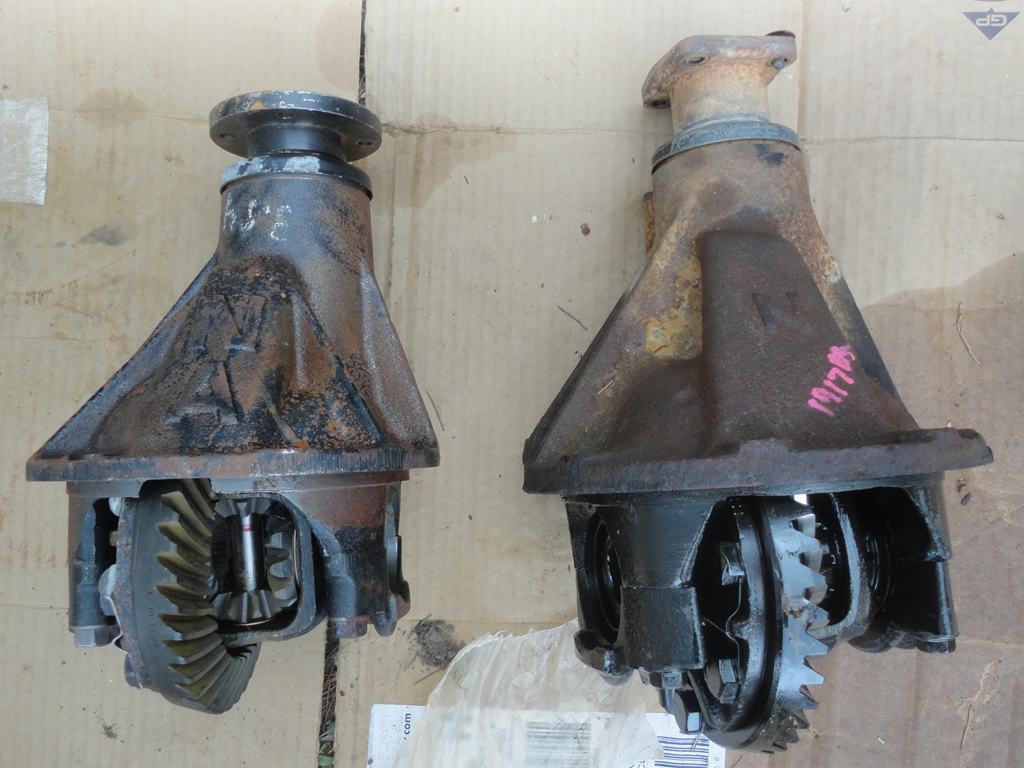

Didnt realise today was Thursday, had a wierd week at work regarding holidays/RDO's, only had time to snap a few quick #OOPS#ty pics just as the sun was going down. The tailshaft is from my old 1200 ute. The H165 has the TRX discs on it, late 120Y borg below it, and pic of H145 from a mate's 1200 coupe.

Here's Tommo's photo
Here's my photo of H150 vs H145:

I think the only difference between the H165 and H145 flanged ends are the protruding boss bit, if the h145 one in the top pic is rotated 90deg the bolt positions look to be the same lengths. I'll have to look at the tailshaft I've got which fits the BW again, it looks like the H150 one in the pics.

Measure the bolt-pattern dimensions, it is more accurate than a look comparison.

H145: 36 x 50 mm bolt holes. 38mm inner circle
H150: 45 x 54 mm. Inner circle 57 mm
H165: 45 x 54 mm. Inner circle 57 mm
H165 from A10: rectangular flange
H150 from B310: larger round flange
H150 from Datsun B310 vs H165 from 1978 Datsun A10

H145 + H165 53 x 45 x 57 centre
BW 120Y Late Model Sedan 60 x 48 x 46 centre
I'll measure the tailshafts next week, forgot to take a tape measure with me

Here's something else to add to the tech wiki, the early model BW sedan diffs use the same yoke pattern as the H145 and H165 diffs, and also the same brakes as the H145. The late model diff yoke mounting face also sits around 20mm further forward from the center of the axles than the H145.
