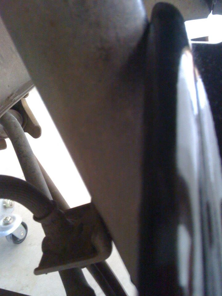

Hi guys im after a pair of 15mm-20mm spacers for the front of my 1200 ute as im have trouble with the rim +38 offset hitting the strut which means i cant even get the rim on properly..as you can see the top stud isnt all the way in properly and its on angle and the other pic is of the rim hitting the strut.Also i was just wondering if i was to put on say 15mm spacers would i need to change the wheel studs to longer ones??

Yes, longer studs.
Stock are M12 x 1.25 32mm long. Knurl Diameter: 13.00mm
Longer 55 mm versions (which are really long)
* NISMO 40222-A0220 [2" long/51mm]
* For B110 front, 510 front
* Knurl Diameter: 12.90mm
These match the NISMO but are shorter:
length 45.5mm
* 40222-15C01 GC22 Van $2.12 USD each

ok i found 2 sets on ebay ill post the links my rims are +38 offset and dont fit by a decent amount roughly what offset will i need to fit them on the front im thinking a 20mm spacer as i was told i need to get it down to like +6 to +20 but can only find 15mm spacers or 25mm spacers in Australia..Also i need to know the bore size of the hub so i can see if they will fit as the spacers im looking at buying are 67.1 mm..the links-
http://www.ebay.com.au/itm/4x114-3-4- ... ae3&_uhb=1#ht_2722wt_1007
http://www.ebay.com.au/itm/1509253676 ... m1423.l2649#ht_2668wt_783
Which ones do yous reckon??

Re: Need Advice on Spacers for +38 offset..
Posts: 31727
Now that you have the wheels, you can fit some washers on the studs as spacers and see which thickness looks best (rather than the previous estimates).

yehh im not sure..I was just thinking that ddgonzal its the only way i will figure out what size i will needhaha thats a weekend job im busy studying for HSC at the moment haha
Thanks
