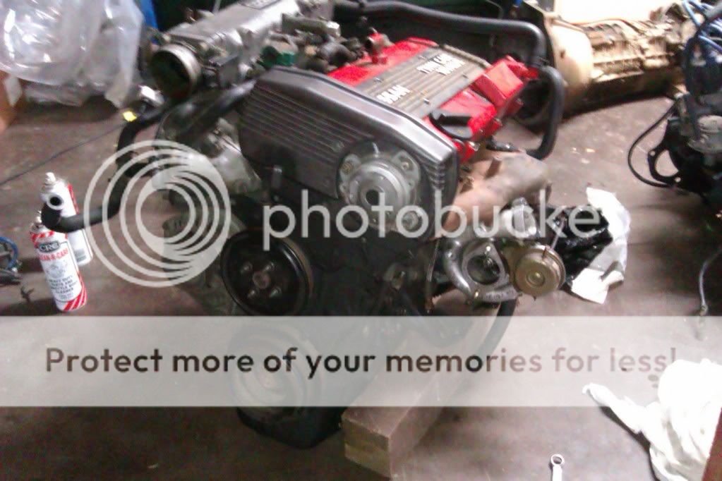

the victim motor...
put gtr injectors and T28BB on it, have a DET ecu tuned for these bits, so will see how it goes
last owner of the turbo welded the wastegate shaft to the housing for max boost.... nasty....

I forgot to mention there was a bung in the de block where the det oil feed line is. so all I needed to do was change that for the oil feeder fitting to hook up the turbo
