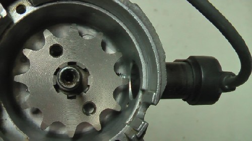

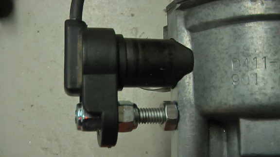

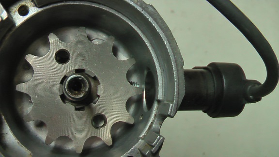

How about I try the $28 modified distributor I have already done and see how stable the timing is? If its ok, at least it will stay that way(unlike a points trigger). It will also be easy to repeat for others.
Are people happy to loose the distributor cap/leads and go with a wasted spark setup?? I was originally going for a stock look, but the compromises are stacking up!!
This is the distributor. The $8. 12 tooth wheel still needs to be welded in place and 1 or 2 teeth removed. All the base plate and advance mechanism has been removed. The the sensor is off the same Hyundai Excel as the TB. If people are happy to go wasted spark, the top can be covered with an ally plate held on with 2 screws.
Its probably a 2+ hour conversion. The sensor has a nyloc nut either side of it to adjust the sensor/wheel clearance.
I know i've virtually repeated what i'd posted on page 10, but wanted to elaborate how easy it is to do. I can't think of an easier way to get a reliable trigger. Just need to test for stable timing. Idle will probably be where it moves around a couple of degrees if at all.

Sikyne do as you will because you are handing out the knowledge. That is a cool mod. I was never aware a chain sprocket could be a trigger wheel. I'm floored, and inspired.

At this stage, I'm just hoping it works!! Na, it should work ok being a hall sensor.
Here is the link to where I bought the sprocket. You can get them from other ebay stores as well.
http://www.ebay.com.au/itm/2814008988 ... geName=STRK%3AMEBIDX%3AIT
I might hook it up to an oscilloscope and test the output before others buy them. Have to weld it in place first.
