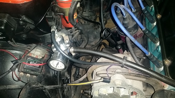

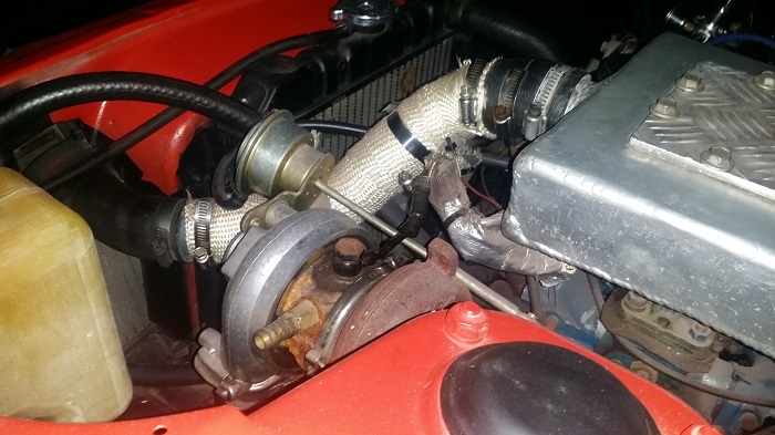

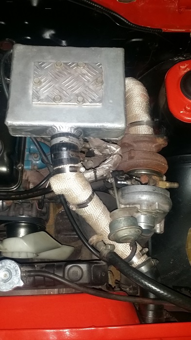

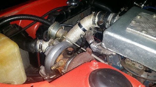

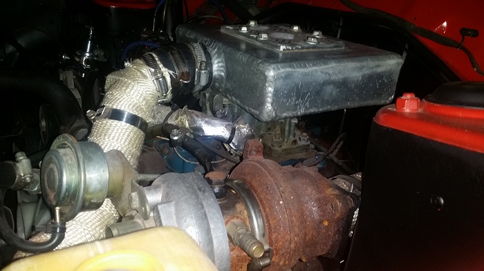

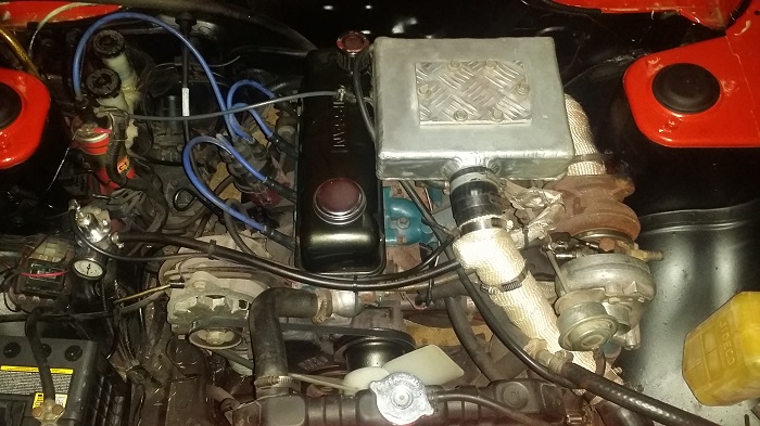

So here are some pics. Any opinions or info from what you can see of the engine build are welcome.
Thanks
Trav

should be fine to engineer . Will need to have pcv hooked up ,maybe bigger front brakes stanza or 200b and make sure the exhaust is under 98db and if ithas a bov it will have to be a plumb back call auto sport engineering at kirawee and see what they have to say.

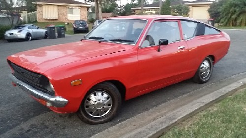

great looking coupe!, hope there isnt too much bog under her as shes had plenty of paint on her.
Hope you can engineer her, looks like a fair bit of love went there
original whitewalls? if so give them a scrub looks really sleeper!
Posted on: 2015/5/14 4:03

Yeah shes pretty straight. Tiny bit of rust bubbling up on boot. Otherwise cant find any. Paint has definately had a few touch ups though. Havent been over her with magnet yet. Engine bay and floor pan are clean as a whistle so should be an easy respray down the track. Unfortunately white walls are a grind job so they will be going. Shame too as tread is 90% on all 4.
