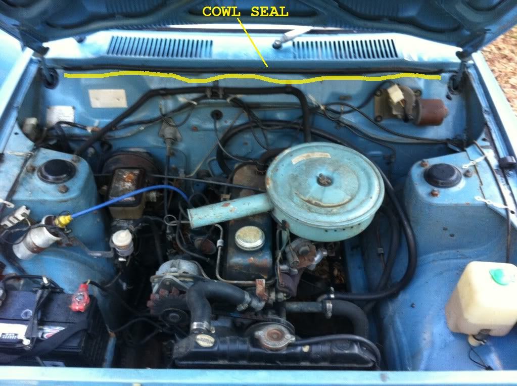

This piece?
Nissan part number 68824-H5000 Cowl Seal
It may be the same as the B110 piece, if so you could cut it to the shorter length used by the B210.
jpg  120Y_Cowl_Seal.jpg (113.65 KB)
174_55680df4ce5af.jpg 1023X764 px
