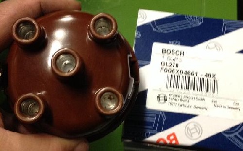

Still putting stuff together.
Bought new plugs, leads, filters and a dizzy cap.
loaded it up with oil and radiator fluid.... just have to check over the timing and the valve gaps.
FYI here's the Bosch number for the early sedan dizzy cap (Lucas replacement)
It's physically bigger than the ute dizzy cap

Does your A12 have a Lucas distributor, what does that look like? Or is it a large-cap Hitachi D4F?

Lucas (prince of darkness) dizzy.
