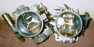

if I were to go find a throttle body from some other car and machine an adapter plate, what size would it be?
Yes, that's a good starting point. For factory-like breathing of A12 use a 33mm throttle body, A14: 35mm, Weber 32/36: 37mm. SU: 38mm
The factory Nissan A14 throttle body

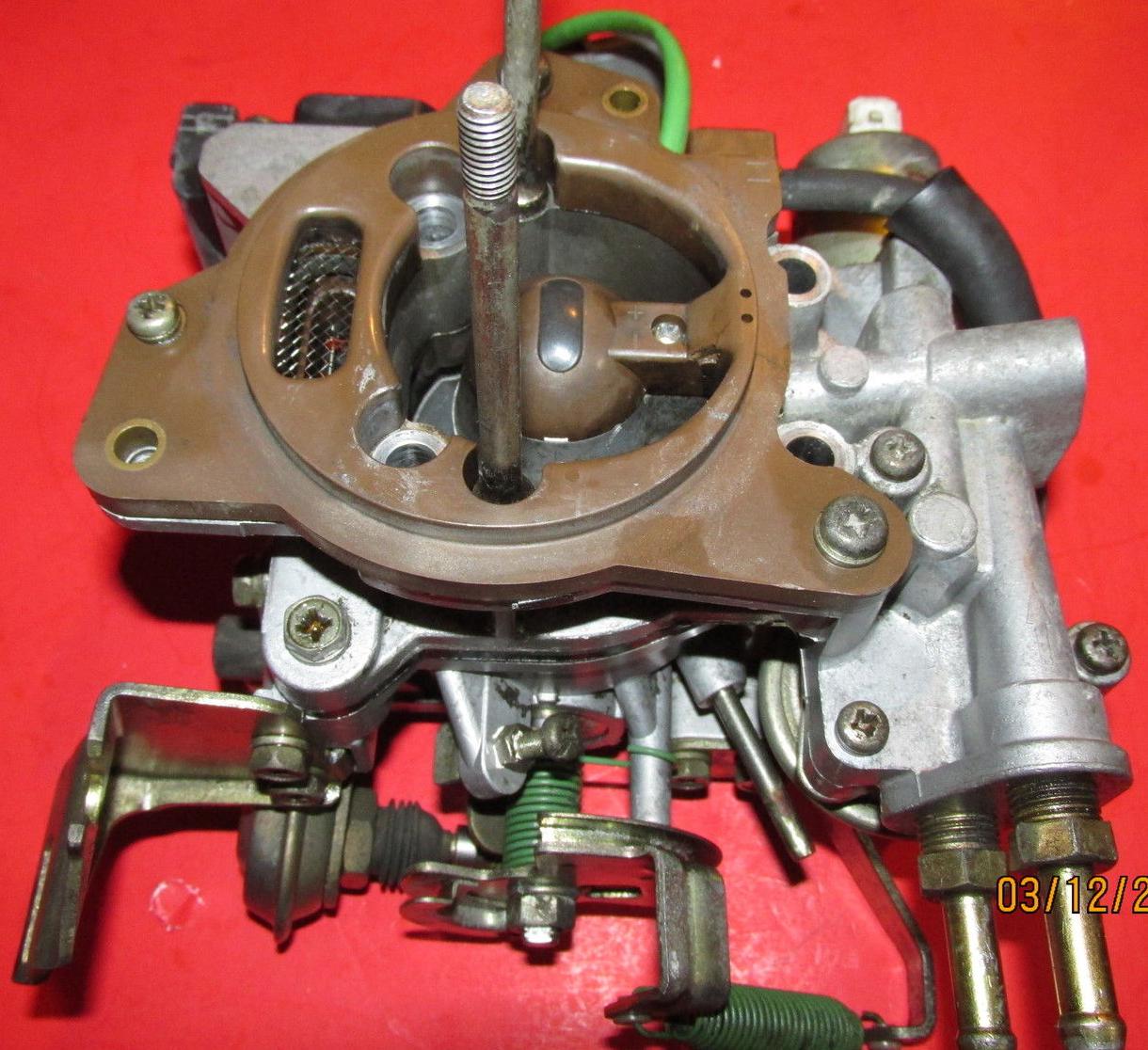

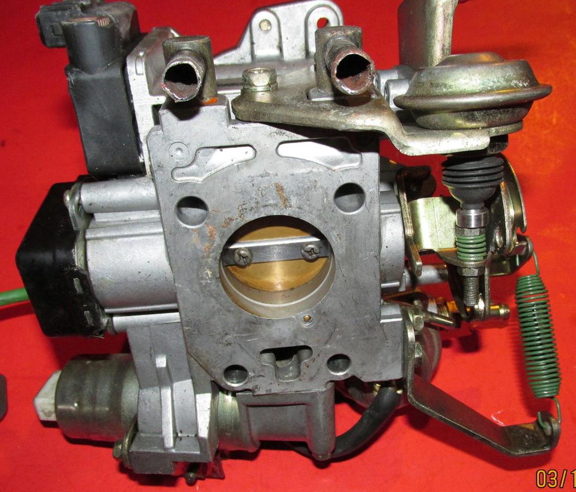

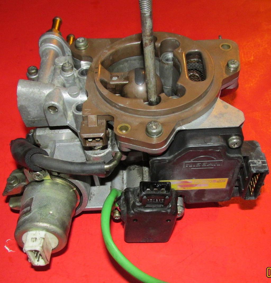

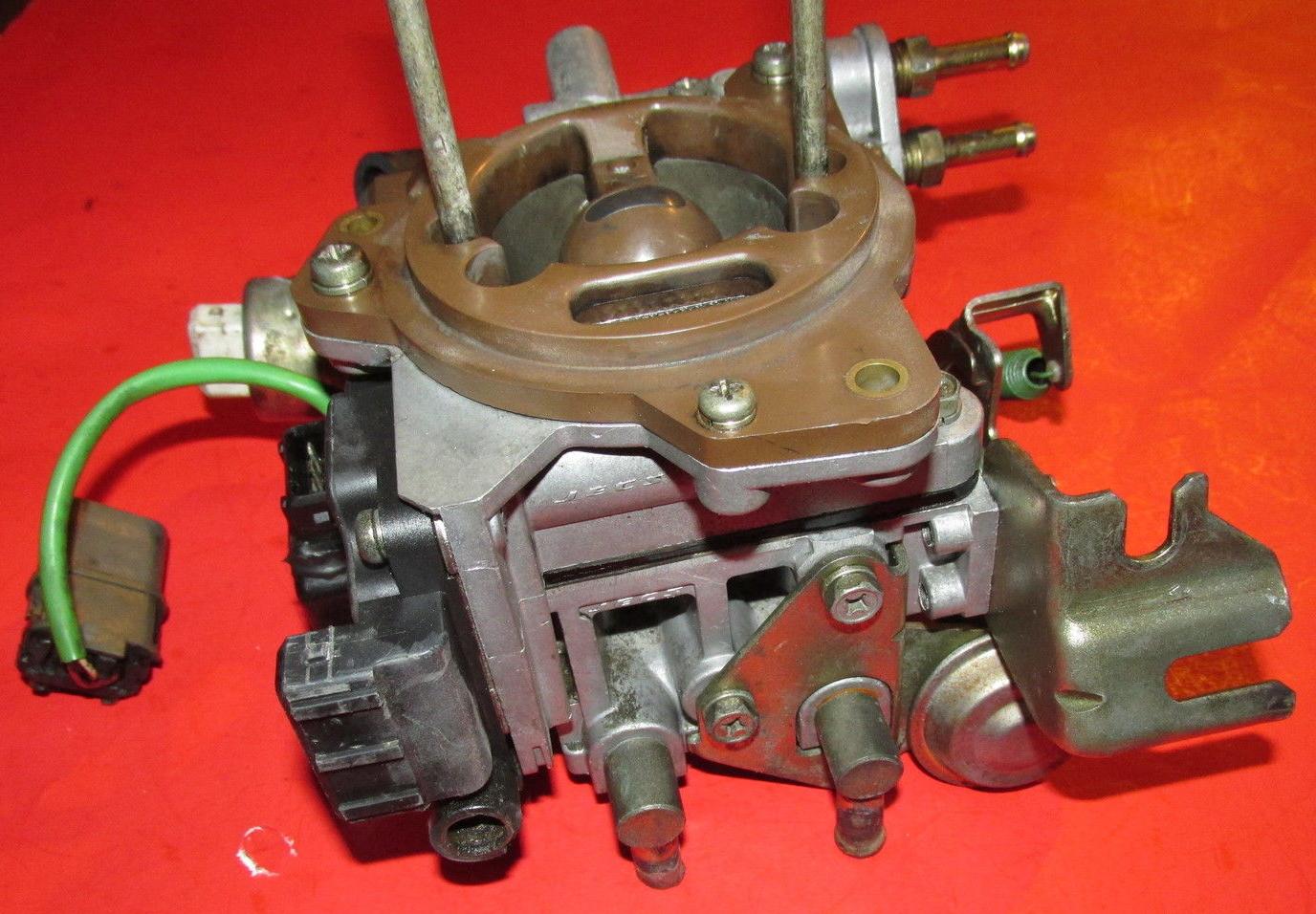

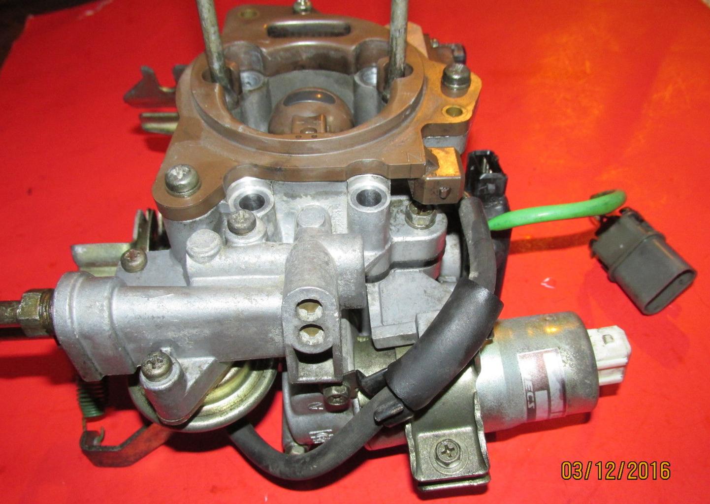

Re: throttle body size question
Posts: 31866
Here's a Nissan throttle body from 1987 Pulsar G16I engine, almost a bolt-on compared to stock A-series carburetor -- and compatible with MegaSquirt
inludes
* 1200 style throttle linkage
* MAF (mass airflow sensor)
* TPS
* IACV (Idle air control valve)
* Fuel regulator
* Injector
Uses an air cleaner & filter the size of the 1200 air cleaner
Normally fitted with a electric heater-grid spacer between the manifold and the Throttle Body, but if used on a stock A12/A14 manifold (which is heated too), then that it not needed
