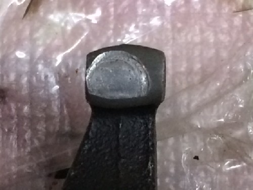

the double springs causes hardness....on turning engine and causes wearing on rocker arms or mine rocker arms are made made with soft material?
Double springs do not cause wear like that
Rocker arms are not made of soft material. Your engine has an oiling problem
T bolt
A14 head used on early (1970-1973) A12 engine -- A14 head does not have the oiling hole
If A14 center bolt is used on A12 block it won't work correctly. Must use A12 center bolt which narrows down in the correct area
Oil passage must be added, or a slot cut in the head, or a slot cut in the head gasket

Luigi, as Dave said the A12 bolt would be the right one. My mistake was using the A12 bolt in the A15 block which partially obscure the oil passage. In my case it destroyed the rocker shaft as well as the rockers.
I would take the plugs out and the rocker shaft assembly off the head, then crank it over on the starter and see if you are getting oil squirting out. Should only take 2-3 seconds.
Also check the aluminum rocker tower that's over the oiling hole to see if its plugged.

* Too much lash: hammers the tip of the valves. Does not hurt the cam or lifters
* Too little lash: Causes poor running, if run for very long results in burnt valve, if revved high might cause bent pushrod and/or valve
Lash does not cause the extreme wear on the rocker arm like this:
Instead of wondering, find out if the oil is working. It's easy to do what Rallytwit said: remove plugs and rocker shaft, crank engine for 20 seconds and if no oil runs out the center shaft tower, it is the problem
