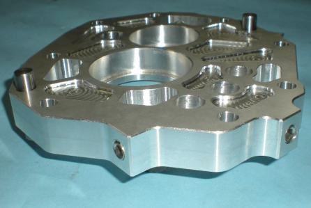

I guess it's getting hard to find replacement Porsche synchros for the GX5 gearbox?
Pitroad to the rescue
* 58000 Yen Borg-Warner synchro conversion kit (about $580 USD). Uses standard 32604-H9000 synchros from the 60L 4-speed
* 300000 Yen Overhauled F5C56A with BW synchros
* 549000 Yen 5-speed with BW kit and straight-cut gear kit ("cross spur gears")Quote:
The 56 has the common name glass transmission. Transform it into a transmission of bulletproof glass ... The front cover & the center plate which is the 56 A's achilles tendon will be changed to a reinforced product ... Since the high frequency sound played by the spur gear is notable, it becomes a circuit exclusive

Lets see ... the 4-speed uses the same front cover as the 5-speed. However the redesigned steel cover is a different shape, dunno if it will work in both. You could email Pitroad and ask. By the way it's 25000 Yen (about $250 USD)
The adapter plate I don't think is the same 4-speed to 5-speed
