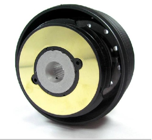

Hi 6 months ago these were available on ebay and now nowhere to be seen. Does anybody know who stocks these or have one for sale? Thanks in South Australia

the eBay boss it is $99 AUD
The Grant boss kit is $38 USD brand new and in-stock readily available from multiple speed shops
I notice the your eBay Boss Kit is using a wheel adapter ring. So while it may be a low-profile design it's not that short when the adapter ring is bolted on
The Grant boss kit looks like it is shorter than the eBay boss kit
You can also use an adapter ring with it to use "universal" Momo/SAAS-style wheels (6 x 70mm PCD with M5 bolts). $30 - $40 USD. With this adapter, it might make the Grant boss kit as tall as the eBay boss kit

This short boss kit is perhaps the most popular Datsun 1200 boss kit of all, made in Japan and available in many countries
$55 AUD in stock
Part number ON-06 fits Datsun 1200 and has a dual-pattern for Momo & Nardi/Personal type steering wheels -- which means you can use wheels from MOMO, SPW, Netami, Sparco, Mugen, NRG, OMP, SAAS, Autotecnica, Boss, Victor, Oba, Rspeed, etc
This boss has the wheel threads built-in, so no need for an 10mm adapter ring

You misunderstand the spacer ring on the ex-ebay kit. It is not an adaptor, just a spacer. It gets used on the face side of the steering wheel not the back side. Therefore it does not push forward the mounting of the wheel. Its purpose, because the boss is so short, is to allow fitment of a horn button without the horn interfering with the steering shaft and nut. You are totally underestimating how short the ebay kit truely is.

Thanks I will try the HKB I already have an autotecnica wheel
