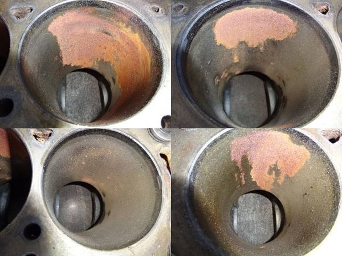

After thinking about it I marked up some of the photos to show the identifying features. It has a 77mm bore and is marked 'A15' but otherwise is a short-deck A12 block

jpg  cylinder walls from above.jpg (113.58 KB)
174_6142888ad589f.jpg 1200X898 px
jpg  cylinder walls from below.jpg (94.02 KB)
174_614288956cd46.jpg 1200X898 px
