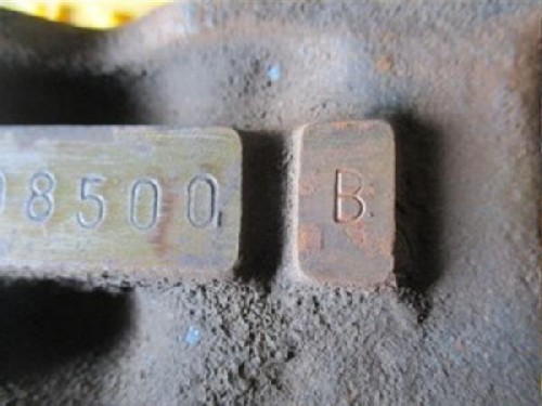

The serial number is interesting. The little pad is stamped 'B"

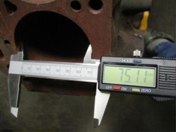

looks like a 1.1mm overbore (stock is 76mm for both A14 and A15)

Yikes, I don't know what 75.11mm means
