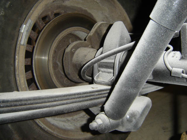

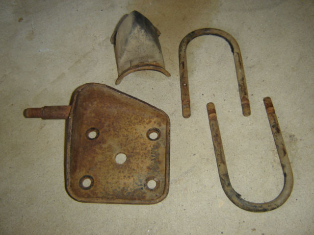

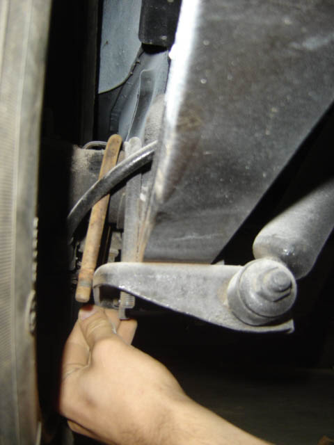

ok not 100% sure this is going to help you, but its about the best i can do.
These are photos from my ute, which has the BORG WARNER diff in it. The other parts that i'm holding up are all standard ute items. This is just to prove that you can put a borg warner diff in a ute using the original U bolts. I can't gaurantee the reverse is true as you are asking
Here is one set (minus nuts, other set is out the back) your welcome to have them for cheap if your willing to pay postage

Cheers for those pictures and that. I might just go to the wrecker and buy the borgwarner mounting stuff. If it works one way it should work the other.

Just for further reference for someone in the same situation. Yes 120y borgwarner bolts and plates fit the ute diff. I bought it all from the wrecker and it fits fine. Cheers Dazza your pictures gave me the hope to try it.
