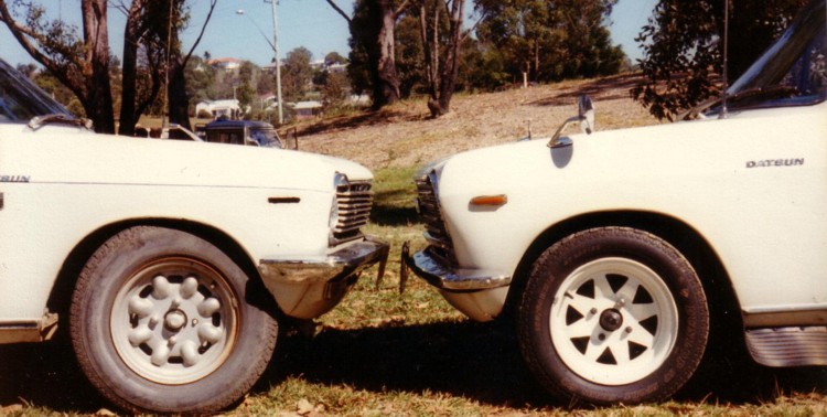

For rear tyres, i would suggest either 195x60x13 or 195x65x13, however the car would benefit from a 1200 engine if you go to these larger sizes as they increase the overall gear ratio & make the engine work a little harder. Sort of like an overdrive.Open in new window
Both these cars [above] use 13x5-1/2" or 5" rims. The sedan on the right uses 185x60x13 tyres, but the coupe on the left doesn't & had dramas every time he hit a bump or turned a corner. The sedan never had a problem, even after mild lowering.
It's the outside diameter that will suck the fun out of it if it's too big.

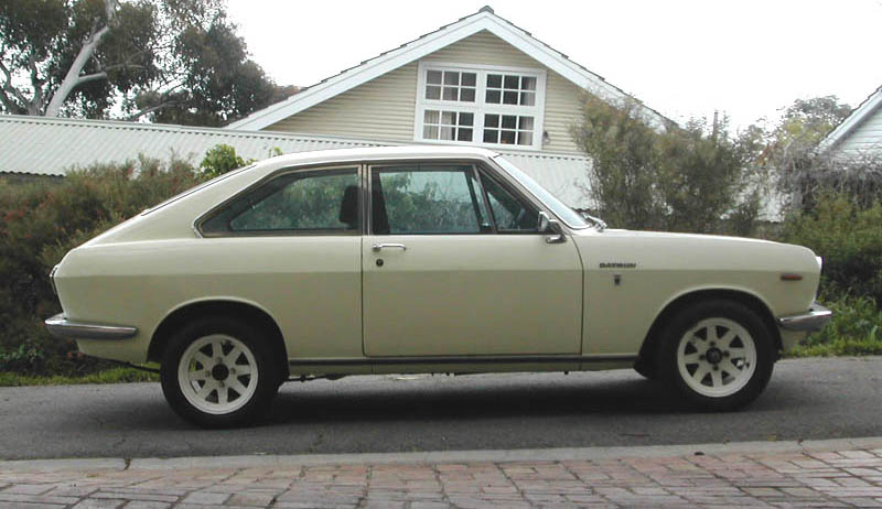

Hmm... those wheels on the right look familiar...
Not sure of offset, but it's borderline. Tyres are as per Dodgeman's recommendation - 185x60x13
TC

both those wheels look really good and suit the car, I particularly like the minilites although there is way to much side wall happening.
