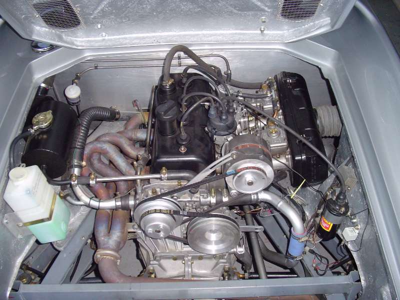

After lots of thinkng I went back to the past and realised the best non pollution all alloy hemi engine to boost is an 807 engine.
Renault saved Nissan and is now part of it, so why not use a WRC winning engine that is such a work of art and can be found for around 50 bucks?
Internals are all forged bar pistons, camshaft sits higher up in the head allowing shor pushrods, its a crossflow hemi, all alloy and way cheaper than an AY conversion.
The only drawback is the oil pump sitting in the middle of the sump but could be modified to run the pick up at the front.

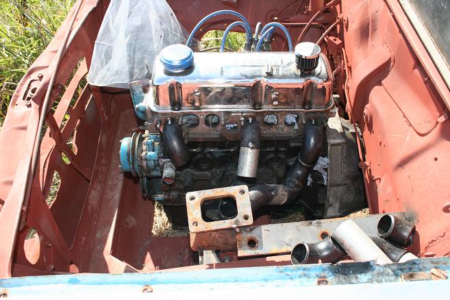

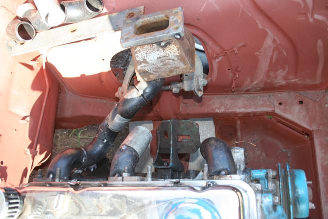

update on my manifold making
heres phase 2 in the making (untill i can walk properly again and get a t3 turbo)
not as pretty with the merger but i just got pissed of with trying to merge them without a collector
