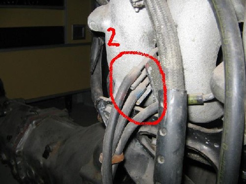

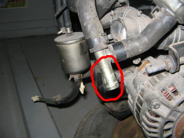

Obviously a pipe connects to the circled part of the metal t piece in first pic, Where does it go ?

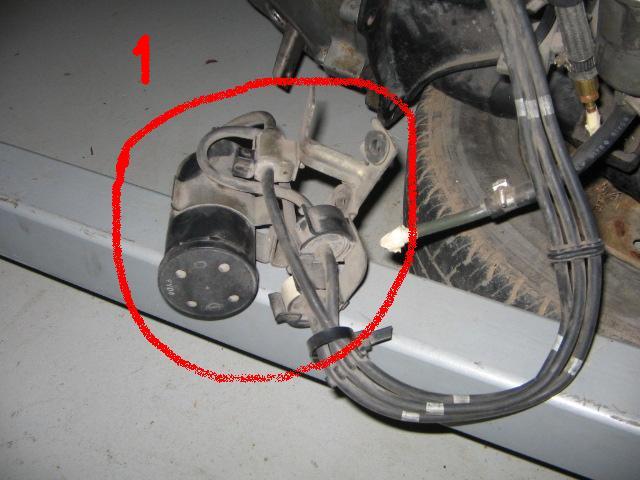

Do i need the little cannister in Pic numbered 1 ?

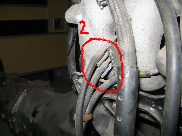

Can i block or re route where it connects to in pic
numbered 2 ?

Big hose goes to plastic crossover pipe after intercooler but before throttlebody. It is the air feed for the idle circuits. If you block that, the idle wont work. Next is vaccuum cannister for power valve. You dont need it if you want less torque below 4000rpm. Hoses can be rerouted but you must retain the different coloured plastic restrictors and one way valves connected in the lines.

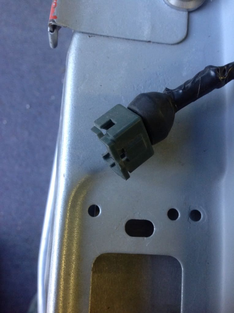

I have a question as well
I have a Kevin rowley loom and can't figure one of the plugs can anyone help
It's a 2 pin plug wire colours are thin brown and thin grey any ideas :)

Anyone know what plug this is for? It's a small brown wire with silver dots and a grey wire with little black dots

Andy. They are just vacuum lines to run all the vacuum opperated things around the engine. One will go to the intake butterflies, which is what dattodude is referring to when he says you will get less torque below 4k rpm
Only vacuum opperated stuff on my car is the boost gauge, waste gate, bov and fuel pressure reg
Don't run any of the standard vac lines

Superfatto, if it reaches all the way to the front panel, then its probably the cold idle solenoid under the throttle body.
