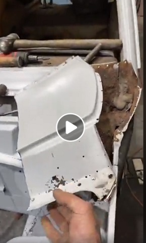

Needs a drain hole
think using 1.2mm gauge sheet
