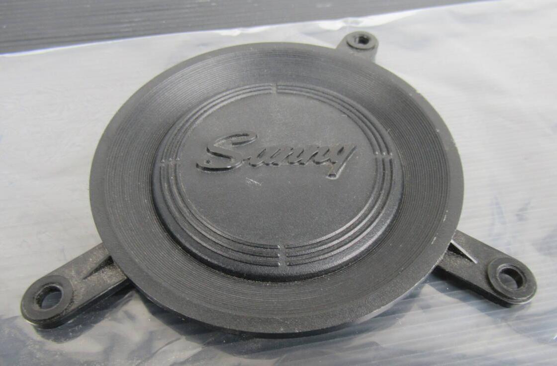

Mask
Cars without the OPTION clock were fitted with a mask
Clock blanking plate (mask)
27181.jpgAlbum 27181
See also: Console#Mask
23452.jpg#Console
H1800 MASK-TACHOMETER "Sunny" [dash mask for clock/tachometer]
26062.jpgAlbum 26062 26766.jpgAlbum 26766 31147.jpgAlbum 31147
H1810 MASK-TACHOMETER "DATSUN" [delete plate for dash]
