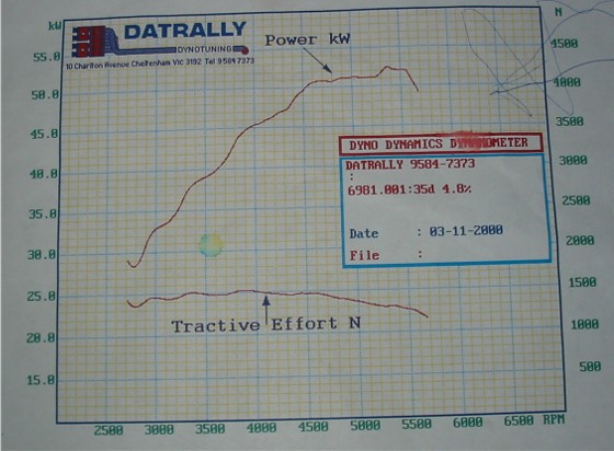

check link for comparison

Is that some kind of crazy torque curve or something up in the top right corner?

um....no
should have said this is stock apart from a mild cam, 32/36 cam and extractors
fun motor, for a cheap build up you cant beat this setup

Ah, 69 rear-wheel HP. This is very impresive for a mildly-modified A-series and shows the potential of the A15 (being 25% more CCs than an A12).
A stock A12 dyno listing reports 38 hp for a 1972 A12, after tuning.
And 43 hp after porting&polishing (more work done than this A15).
69hp vs 38hp. Go the A15.

The torque curve tells the classic A-15 story pretty well- feels strong from very low revs but runs out of breath over 5000-5500rpm.
