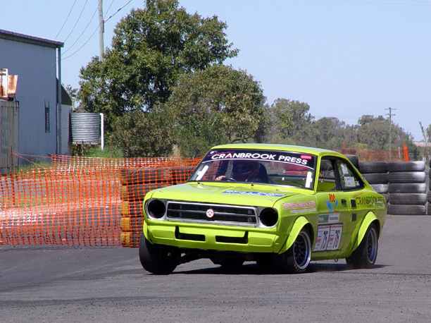

It appears to be the turbo and supercharged toyota powered 1200 coupe at Pittsworth street sprints,QLD Australia.Fastest car their.GREG
Cameron_Datto
Posted: 2005/11/20 12:00  Updated: 2005/11/20 12:00
Joined: 2003/12/26
From: South East QLD
Posts: 252
 Re: Bright Green Race Coupe
Thanks for the interest in the Car ..I built the Car about 7 yrs back ,, And have ran it in the sprints for the last few years . My mate owns the car ,, but i own all the go fast bits on the Car ,, iam constantly changing bits on the car to go faster ,,when i get some spare $$$ Its a Real Fun car to drive ,, The car is faster than GTR Skylines even with a 2.7 stroker,, The Skelta ,, I Came 2 second Outright out of aprox 120 cars at The Pittsworth Sprints this year ,,First Place was Open wheeler with a motor bike engine it ( It Holds the Qld Hillclimb class } ,But it was only 0.5 second faster ,,
Last year i won the event Outright . Let me Know if you want any info and yeah its Supercharged and Turboed .. Cheers cameron

what rims are they, they look hot
nice work

The rims in the pic are 13x7 hotwires which is a old pic ,, I now run 13 x 8 Superlites ,, iam really wanting to go to 13 x 10 on the rear ..If i can find a right tyre to use with the wider rim ,,

Hmm,, there is a lot of bits ,, fibreglass guards ,bonnet door skins ,flares ,,
4 spot calipers front ,, Satchell 4 link rear ,, H190 alloy centre ,,Need a stronger Gear box with a taller 1st gear ,

you runnin a t50 i take it?, um have you looked at a t40 not sure about ratios but it should be a taller box altogether, dunno about strength though.. and its only 4 spd
or a supra box - w58

A w58 and bell housing is on my To do list ,, I have a T50 sprinterbox in there at the moment which i must admit stood up well considering the torque ,, I have only gone through 1 box ,, T40 is the 4 speed box , the 4 ratios are the same as the T50,,

try a supra box ? a mate of mine used to run one behind his 80's v8 commodore.
rad car, great results congrats Cameron
