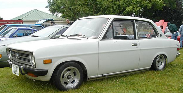

with grippier semi slick tyres on the stock suspension you should have far more body roll, but seeing as you haven't pushed it to the limits yet I guess you don't know.
If there is a reduction in body roll in normal driving, it must be due to the massive change in your roll centre caused by such a radical change in tyre height.
But I think the biggest change you're feeling is the increased responsiveness of the semi slciks.
There is definitely no increase in the risk of rolling a tyre off the bead in low profile tyres. And certainly not with semi slicks! They can be a pain to break the bead using a tyre machine!
4WDs with monster tyres use bead locks to allow them to run stupidly low pressures (like 4psi) for traction on extreme rock terrain by allowing the tyre to deform over the rocks and keep more tyre in contact with the surface. At less than 14-16psi a 4wd tyre is at risk of popping off the bead. Its a very different thing to passenger car tyres, and has nothing to do with the prefole of the tyre.
Posted on: 2007/7/9 1:53
Re: How to lower a 1200
2003/7/13 14:43
From Portland OR. USA
Posts: 268
Hi DD,
I can see 3 things contributing to the lower body roll, possibly 4.
1. Much stiffer tire sidewalls. They don't deflect nearly as much as the old tires.
2. The aluminum wheels are noticeably stiffer than the steel stockers. You can feel the difference.
3. Lower center of gravity. Not a big change but it should help.
4. Slightly wider track?
The basis for #2 comes from experience gained many years ago. I re-drilled some Fiat mag wheels to fit my Dato. The wheels were the same dimensions as the stock 12" wheels, both in width and offset. The tires were transfered from the steel wheels to the aluminum wheels so the only change was the wheels. The difference was quite noticeable, with the car having a more direct feel to steering inputs.
Posted on: 2007/7/9 15:54
2004/7/15 12:10
From Adelaide, Australia
Posts: 3931
I lowered my daily driver sedan the other day, I used 280z rear springs with about 2 coils cut. I used a mix of leaves from a corolla + 1200 leaf pack to get the car lower. I drained front drum struts and filled with bel-ray fork oil, also fixing a savage leak from one of the strut legs. On the weekend I put some bilsteins in the rear I had laying around from a bmw 320i, I had to remove the spring seats though, its also got a 120y front swaybar.
The car has been transformed, its so direct now with the extra stiffness upfront and the cornering is fantastic, it has none of the bumpiness it had with the monroe gas shocks on the rear and leaking left strut. The only real complaint I have is its a tad too low.
The wheels are 14" pintara wheels with 175x60 Bridgestone supercats, I get no scrubbing except at full lock on the front of the guard, that would be because of the 3mm spacer to get the tyre away from the strut a bit more and the extra castor we got out of playing with the castor bushings.
