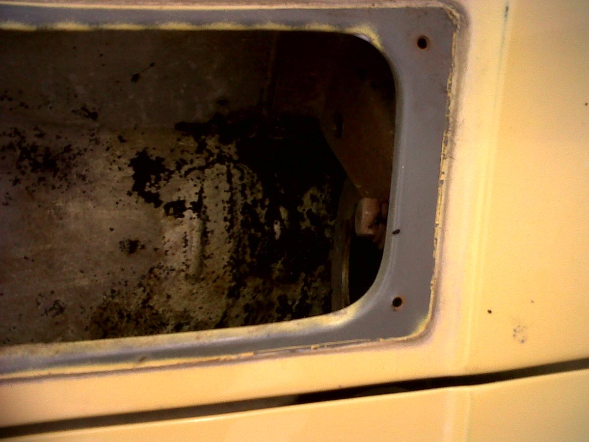

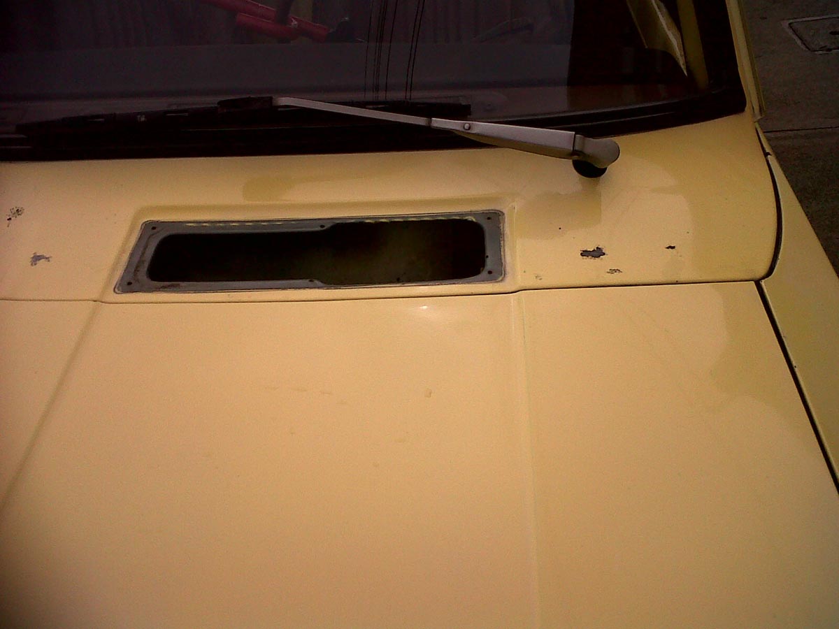

Hello again. I really need expert advise on this one.
recently on my country ocurred a volcano sand rain, it was all over the cars and my Ute was not the exception.
Sand entered all around the car and inside the top grill too. Now what happens is that water is stucked in it, cause i think drains are blocked. This causes water to go in the cockpit through cowl top ventilating system.
I have extracted most of the sand but, i want to know.. HOW CAN I CLEAR DRAINS so water can go out of it, and, WHERE EXACTLY ARE LOCATED THOSE WATER EXITS ON THE CAR.. all information will be very useful guys.
thanks a lot.
best regards..
ps. here are some pics..

Have a look at this thread http://datsun1200.com/modules/newbb/v ... id=311167#forumpost311167 there's photos of the affected areas. If you don't clean it up you will end up with rust holes just inside the bottom front quarter panels (near the door)that's where my one drains out at the moment
Posted on: 2010/6/3 10:05
Re: How can i clean.. TOP GRILL water exits on a Ute?
2004/10/28 11:35
From Geelong, Vic
Posts: 6184
to get to the drain, have a look inside the front guards up towards where the guards bolt on, there should be a hole at the back of that top rail area. if its blocked you will probably have to backwash it through that hole first

Hey thaks a lot guys! Right now i'm looking for it and i will try to clean it ASAP i will let you know any progress
Posted on: 2010/6/5 15:21
Datsun Project.
Not too shy to talk
2006/2/23 22:41
From Guatemala
Posts: 24

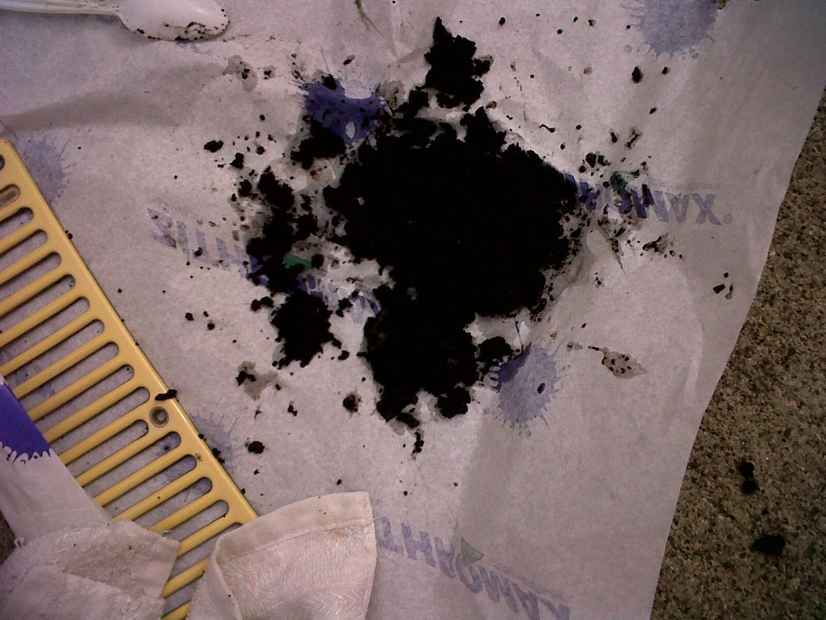

Again.. thank you for the advise guys.. everything went just fine with the rinse and cleaning.. i took about about 6 pounds of dirt, ash and vulcanic sand..
