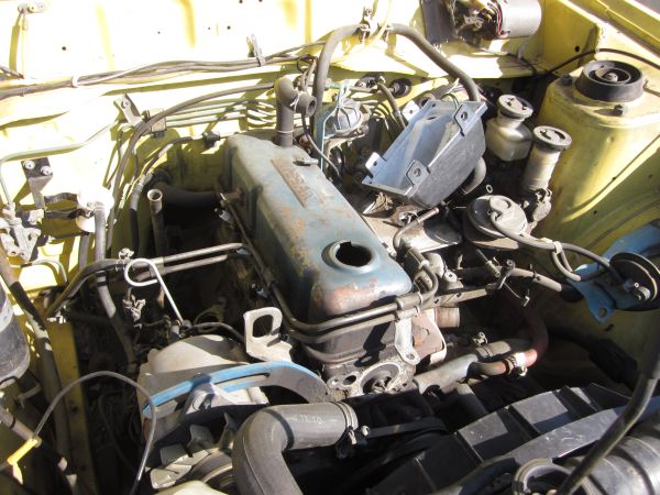

The alternator bracket......grab that , mine broke and I don't have a spare, hint hint.

it still has the alternator bracket

Actually that style bracket I have 4 of. The GX head on the motor doesn't have a bolt hole or even boss for the bolt hole. My spare GX head has the bolt hole boss but no hole. i was using a straight bracket bolted to the thermostat housing, that one must have been an A12 bracket. Time to fab an adapter.

This is the later style
early & late adjuster bars
B110 bar is much longer
