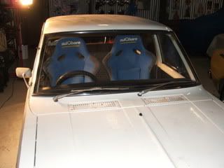

Hey guys, Im looking at getting my Halfcage booked in to be done in the next few weeks, has anyone got ideas of what will give most strength and ridgity in the shell and also legalitys for CAMS, i havent gone and organised license yet so dont have the 07 book. I dont want someone to build me a lemon cage. Im looking at running supersprints and the odd hillclimb next year and would like to step up to improved production 2008/09. Ive been told i can tie in a full cage at a later stage also. If anyone also has places in Adelaide they would/would not recommend also let me know, i dont want to make a mistake and take it somewhere where they wont respect the dato and bodge it up. Cheers Sean Here it is at the moment, waiting for more money to be thrown at it;

Cheers guys, I think im gonna chat to Craig tomorow see what he reckons, I just want to make sure i dont get a Lemon car i cant use in the future when i want to run Imp prod. I like the sound of those bond cages converted, im sure Maddat would be able to do something similar, a half cage for now and full cage later.
Tpnshow, I mounted them to the rails for now, was pretty straight forward, i drilled the velo mounts to suit the dato rails and used new bolts with nylocks. Im not sure if it is legal to do it that way, should be alright for now. Need to get the cage in so i can use them and start driving the thing.
I got the seats for $320 off ebay, they used to be in the autobarn dorift car. Im happy cause they used harnesses so no tears, just a few stains, im getting new covers from Velo anyway.
Does anyone know if they will check dates on seats for supersprints? I cant find a date on my velos at all?
